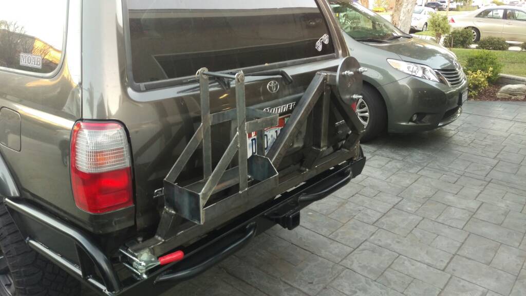

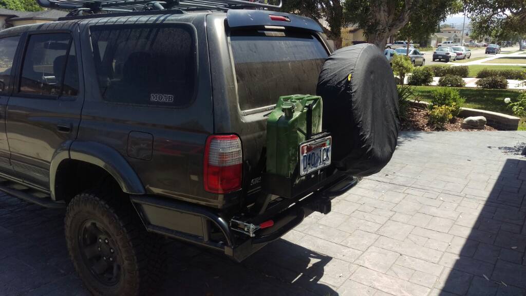

Rear bumper + tire/gas carrier.

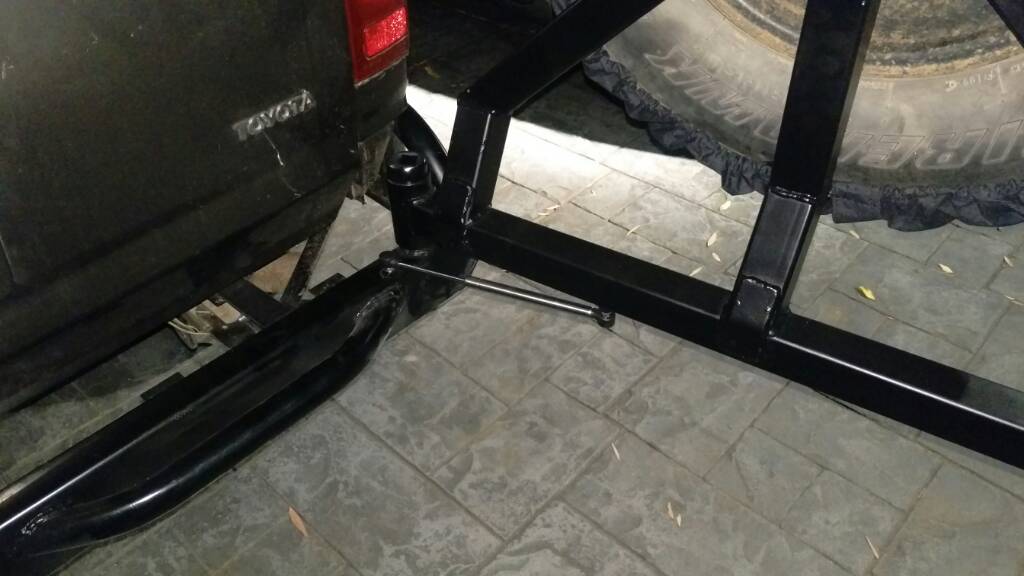

I like it much. What did you use for the hinge?

Ok, thank you. Again the problem is, we cant get such things here very easely. So, I think I need to find someone who goes on a trip to the Netherlands and want to bring it along for me.
But it is a smart thing.

@Robert OB 33/48 I used the same part for my swing gate, essentially it's an axle from a small trailer. It has a 1.5" solid steel pin, two cartridge bearings and an outer race with a 2.25" outer diameter. I think it's rated for 2000lbs. If you visit atozfabrication.com they have it listed under builder parts. I would think something similar would be available over there, maybe from some place that sells small utility trailers?

That looks damn nice......
Now, rotate that Jerry Can holder 90 degrees and make room for another Jerry Can, or Water, or C02 Tank. You've done all the hard work now mount some Stuff.......
