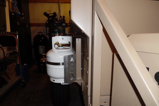

finished up yesterday with my propane tank bracket project for my overland trailer.
I ordered 5lb propane tank & aluminum propane tank mount from AT Overland Equipment http://adventuretrailers.com/ https://www.facebook.com/AT.Overland/
I fabricated the bracket to hold the mount & painted it to match the trailer. This way I can attach it to the trailer chassis instead of the tub which will give me a more strength. I wanted a set-up that wouldn't exceed the fender.
I constructed from 1 1\2" thick wall tubing, 4" x 4" x 3\16" angle iron, piece of 3\16 x 1 1\2" strap, 1 1\2" black plastic tubing cap. The bolts & screw I sand blasted & moly coated black to match the rest of the black on the trailer.
