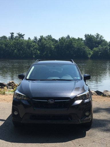

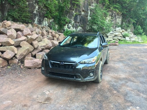

This is my build thread for my 2018 Subaru Crosstrek Premium 6spd. I ordered the car from the factory on 4/20/18 and took delivery on 6/23/18. I am aiming to build this for moderate overlanding. I know it's not as capable as a Jeep or Truck/SUV but it fits my needs perfectly.
Current Mods:
Protection:

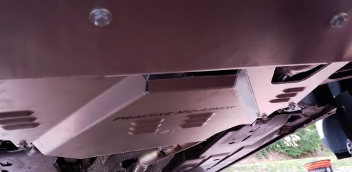

Primitive Racing engine/trans/diff skid plates
Rally Armor flaps
Wheels/Tires:
15x7 Sparco Terra wheels
215/75R15 General Grabber A/T2's
Lighting:

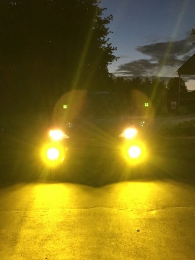

Baja Design Squadron Pro amber wide cornering
Comms:
Uniden CMX760
Firestik FS4 antenna
Recovery gear:
Draw Tite hitch
Wilco Offroad hitchgate solo
X-Bull 10T recovery boards
X-Bull d ring receiver
VooDoo 12k recovery rope
QIQU soft shackles
Superwinch strap dampeners
Planned Mods:
Suspension:
ADF 1.5" lift kit
Body:
Tube frame front bumper with winch mount
Tube frame rear bumper with swing away tire and rotopax carrier
Rock sliders
Lighting:
Auxbeam 42" curved 5D light bar
Cargo/Camping:
Overland Pros Wraptor 2000
Road Shower 4

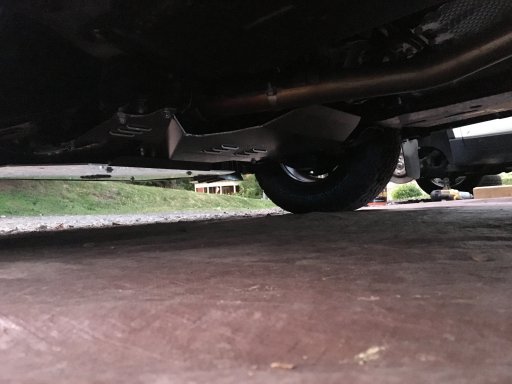

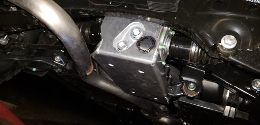

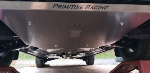

I plan on overlanding as well. one of my first mods was the primative skid plates and rear diff plate. however when I hit a rock, the skid plate isn't mounted to take an impact. the plate is super ridged and bent my radiator support [emoji24] hood sits funny now. but I've got it back to a somewhat acceptable gap [emoji38] also as a manual, it seems the transmission plate is useless. there's so much clearance bc our manual transmission are a lot smaller than the cvt. however, it will aid in keeping things rock free when rallying [emoji16] also, you lose ground clearance. I was anticipating losing some, but an inch in some areas... that's was a bummer to learn.

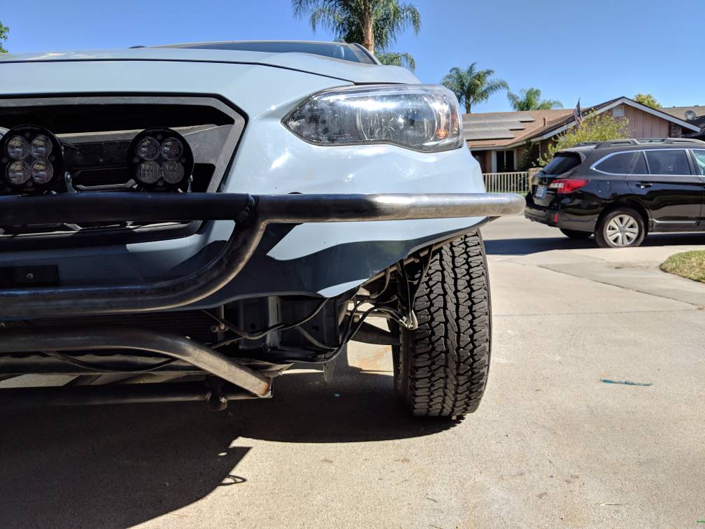

guess its not an honest old fashion conversation because we have road going cars that can go off-road and not vice versa. nor would I want it to be that way. I'm not rock crawling. that's where I know my cars limit. anything but that, I'm willing to try in my a/t tired, skidded and now custom front bumper (for approach angle) equipped Crosstrek that still gets 28mpg on the highway [emoji23]
