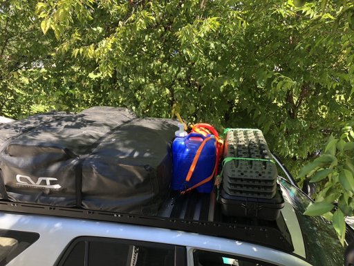

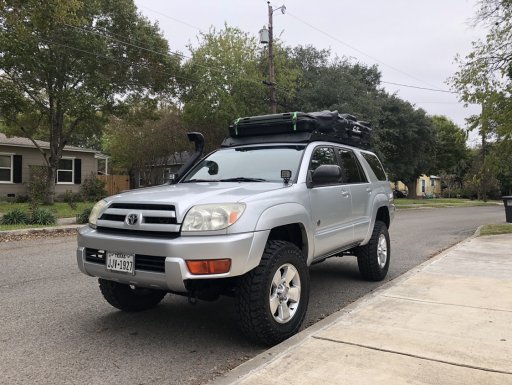

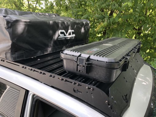

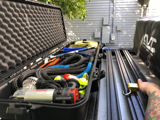

I’ve had a 4th gen 4Runner version of this rack for a while. I’ve got some pics below of it loaded up. Plano recovery gear case up from, bolted to crossbars, RTT attached to a set of crossbars that drop into place, and are removed with the tent.
Honestly, the rack is fine, but I’d do frontrunner or eezi awn k9 if I could do it again. With extra crossbars and a bunch of stainless hardware, I’m pretty sure I’ve ended up spending as much as I would have with one of the other racks I mentioned. Things I really don’t love about the rack:
-No side overhang, makes side mounting anything difficult when you’re working around permanently mounted things like RTT’s
-too adjustable, doesn’t come with enough crossbars stock. This level of adjustability isn’t necessary IMO and it makes the entire setup more complicated.
-almost no accessories available. Biggest reason I would go with frontrunner.
-only 2 mounting points on each side to the roof (vs 3 per side, requiring drilling, from frontrunner) and it’s just not quite as heavy duty as I like.
It’s not a bad rack and I’m not spending the money to switch it out, but I would make a different choice if given the opportunity again. It doesn’t matter if you think you know exactly how you’re going to setup your rack now, it’s going to go through multiple iterations as your rig grows and changes. Adaptability from different accessories is key. And the prinsu just doesn’t have it. I havent had a single “problem” with the rack and it’s done everything I needed. But my overall reaction to it has been that of being underwhelmed. It’s just not AMAZING and not HEAVY DUTY. Granted, mounting to T slots on top is easy. But side mounting anything is a major pain. IMG_2623.jpgIMG_2243.jpgIMG_2226.jpgIMG_2229.jpgIMG_2242.jpgIMG_2244.jpgIMG_2245.jpg

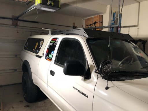

In the ‘05 and newer, it bolts directly into the tracks. On Gen1 Tacoma, I had to drill holes in the roof. Not my fave thing to do, but the only option with Prinsu. The jack-bolts were a pain in the ass. I managed to get all but one to seat. I may just drill thru and lag bolt them in. In discussion now with CBI about the kit they sent...still not positive I received the correct one. There are differences in the hardware and fitment between what they sent and what the instructions show...so...I’ll update as I find out.
