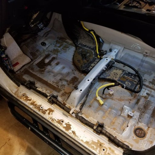

I am sure you are aware, but if water is high enough to get into your engine it is also filling your cab. Ask me how I know..
And Arkansas mud smells like ass.
That sucks. Really try to avoid that.
