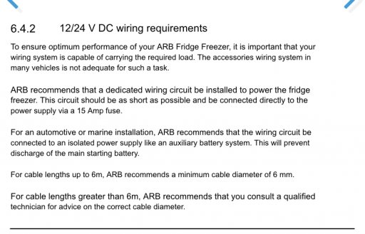

That panel isn’t going to power your fridge... it’s only rated for 15 amps total... What fridge are you using?

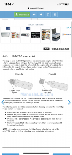

The .85 aMp hour draw refers to the parasitic drain on the electrical circuits while the unit is on. The cooling/heating system draws up to ~12 amps on startup. ARB recommends a dedicated circuit running 6mm wire under 6 meters long with a 15 amp fuse.
If you are using the ARB 50 fridge or similar, @MonkeyTrev, this is correct.
6mm wire is 10AWG in the US. Stranded wire is more flexible than solid. The higher the strand count the more flexible it will be in routing from your battery, if making up the wiring run yourself.
ARB sells a ready-made wiring kit with a screw-in 12v receptacle, cover, 20' of 10AWG and a fuse in the right place. I've been running my ARB 50 non-stop for over 2 years and can tell you the threaded mount is handy. There have been times I thought my fridge was plugged into my 12v extension when it had actually jiggled loose while running back country roads. Still in the socket, but not powered. The threaded mount prevents that.
