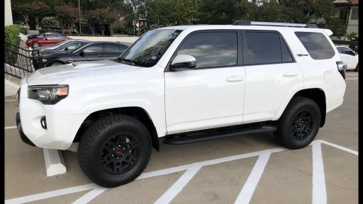

image.jpeg I recently purchased and installed RSG flat sliders, powder coated, for my 18 TRD PRO. I'm older and can't imagine dragging my expensive toy over boulders especially having to drive hundreds of miles home. My sliders are more for accidental encounters than deliberate use. But, I concur with the sentiment that if you are going to use them go painted.

That’s funny. I inquired about linex. Said if powder coated would be cheaper to do. Bare required extra prepping. Haven’t had mine long but still look outstanding.
