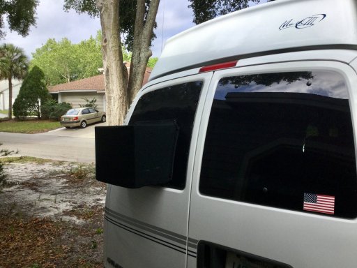

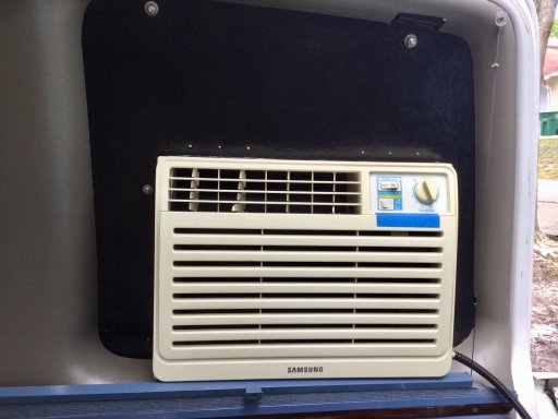

I have a 5500 BTU mounted in my rear window. Having AC in the summer in Fl is a must. My first build was a 4000 that didn’t cut it..the van was also brown which didn’t help . When hot sun hit the truck at sunrise it was like turning on an oven. The 4000 couldn’t keep up. This build I went up to a 5500 also the new build is white. This worked great. Also with the new cheaper units the low btu models have a plastic frame which would be a mounting issue. The Samsung 5500 had a metal frame and energy star rated. Took the original rear glass out and made a fiberglass blank. Custom cover from a local canvas shop. Disassembled unit and replaced all the screws, nuts and bolts with stainless. Thru-bolted a 1” steel piece of angle on bottom to mount to the rear door. We use a Yamaha 2000w Inverter/ generator when boonbocking that handles the load very well, I wouldn’t recommend anything below 2000W . Initial startup definitely puts a load on. Been working great for over 10 years.
I also run a 2K pure sine wave Inverter w/ 2 group 31 AGMs. Never tried to run the air with it, which I doubt it would handle the initial start. It would probably take down both batteries in minutes. Even using our microwave makes the voltmeter drop like a rock.
