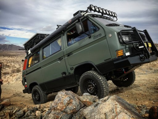

Hey there everyone! We've been building out our Syncro over the last year to get it ready for some long term overlanding. We’re reaching out to the community to ask about any resources you know of in the southeast US.
After some long discussions with members in the community, we decided to install a 1.9L TDi PD BEW. The process of getting the engine and getting it installed was a very long and frustrating one. It was finished mid-August and has never run as advertised. We are looking for a shop in the southeast that can assist us in dialing in our set up. They don’t necessarily need to be an expert on Vanagons but they do need to be an expert on turbo diesels and preferably have experience in dealing with custom overloading rigs.
