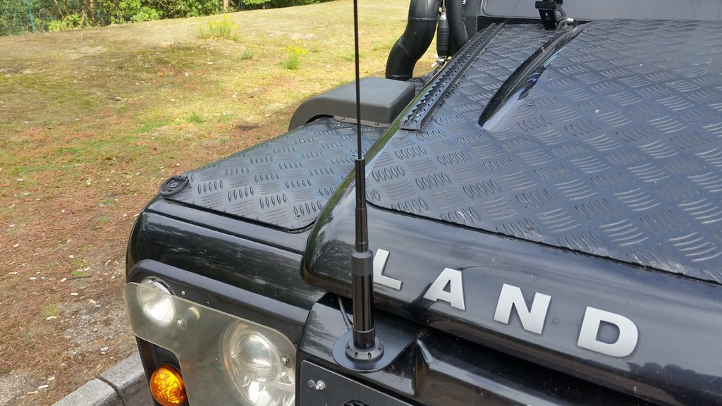

I run the same antenna for 70cm/ 2m band. Mounting position at the very front of the car, because the other places were already occupied by other antennas.
With regard to ground plane not a very good mounting position, but it works without problems with this antenna.
