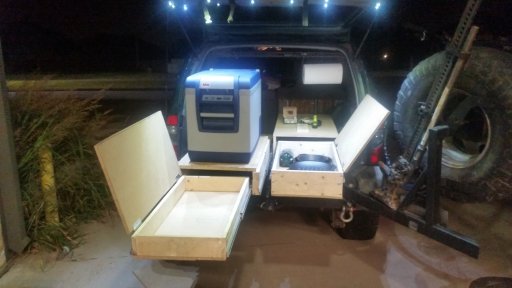

i just had the chance to test out my new kitchen/storage system this last weekend out in the ozarks. it worked fantastic!
i built a drawer system for my fridge and other gear, but instead of just having basic drawers, i added tops to 2 of them to double as tables when they are pulled out. In one, i keep my coleman stove and some misc. stuff, and the other has some cast iron skillets, a dutch oven, small backpacking stove, cooking utensils, plates, bowls, etc.
the left side is a double slide out so i have better access to the fridge, and has a table that come out underneath it. The right side is just a single slide out.
i also added some small LED bolts into the rear hatch panel to add some good lighting when cooking. As we learned over the weekend though, they function amazingly well when you have a group trying to look at a map to do some planning. There wasn't one shadow to been on the map with 4 people looking at it.

thanks! i need to go back and change all the slides to locking ones, and also make the left drawer into a 6" tall instead of 4" tall. I also plan on replacing the tops with some cutting board material instead of the MDF

Nice Job!! Love your set up! Makes me want to start a winter project. I am going to be installing an overhead rack in my LC too. They are on sale for $19.99 for the black shelves.
Do you have a power source in the rear compartment? or do you run electrics from the front?

as of right now i have a single 12v power outlet in the rear from the factory that i rewired to my aux fuse box. I will eventually add a few more back there for different purposes. Also, currently i'm running a single battery setup, with plans to add a second battery and controller/isolator as soon as i can find room to put on.
