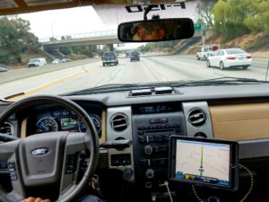

I first started off with an android tablet with built in GPS mounted to a custom bracket I made that mounted to my dash. At first this seemed to work pretty well but the further I got out to the middle of nowhere the spottier the internal GPS got. After doing some research i came
to the conclusion that I needed an external Bluetooth GPS. I settled on the Dual XGPS 150A. The Dual GPS works on not only Android devises but also on Apple products. Once I did the initial install my spotty GPS was non existent.
My next issue was with my custom mount... now it worked great with very
little vibration but with how high it was mounted I would get a lot of glare and was nearly impossible to see during the day so I bit the bullet and order a whole setup from Ram Mount. The install was super simple with the main bracket being mounted under my passenger seat via the 2 front bolts. Once it was all together I added a X
grip on the side of the tablet mount for my phone... This setup worked very well but it did have 2 downsides.... Because of how the arms were positioned it would shake a lot on dirt roads making it difficult to read. The next issue is the amount of space it took up. When i was using it I did not have access to my cup holder on my center console and if I pushed it all the way forward to access the cup holders I then didn't have access to most of the buttons on my dash. After running this setup for about a year I knew I had to make a change...

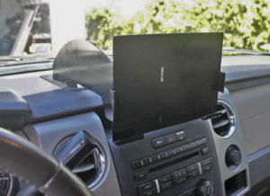

Mob X tablet mount:
For my tablet setup I went with the Mob X mount. Generally this is mounted to your windshield with the provided plate with suction cups but i knew I wanted mine mounted on my dash. We cut out a simple metal
plate and mounted it to my dash. During this same time I upgraded to an Ipad Air 2 with a otter box case. The Ipad with the case fits Perfectly between the adjustable arms. I know some of you are wondering if the
magnet holds the weight of the iPad during off road use. The answer is yes! The magnet is so strong that if you try and take it directly off without sliding it off the plate it will start pulling my dash off.
