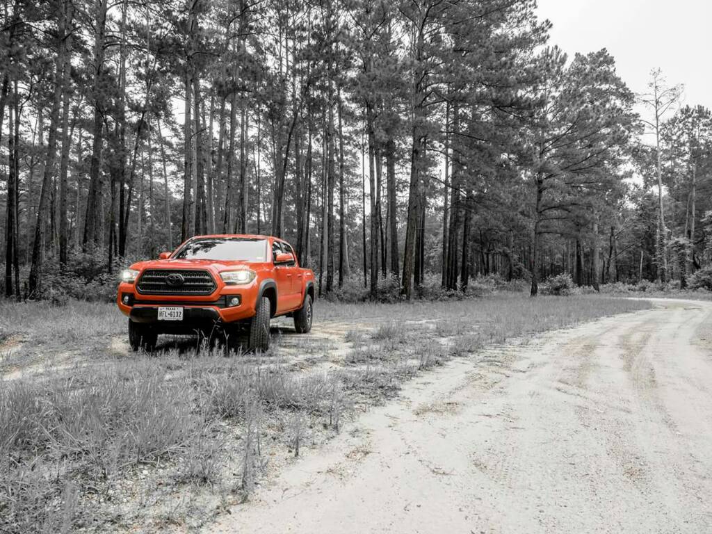

I'll be building a 2016 Tacoma TRD off-road. This is my first build. Curious as to what order you would build everything. Also any Tacoma owners I'd be interested in your feedback on my parts list.
King coil over shocks
Ome Dakar springs
CBI front bumper..do I really need a hoop?
CBI rear bumper with swing out tire holder
CBI sliders
Trd pro wheels
Tires tbd
Dual battery setup
Winch warn synthetic... model unknown
Skids TBD
Arb under hood compressor
Tent camping to start and move into a AT trailer with a hard shell RTT.
Thanks

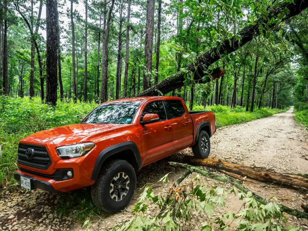

Love the color of the truck!
Reactions: mmnorthdirections
whec716
This is a serious point to consider!. Especially if you are increasing the lift of the vehicle. The OEM ball joint will not last long at all once you start to flex the suspension. They have a very limited range of motion.
Total chaos UCAS ordered
