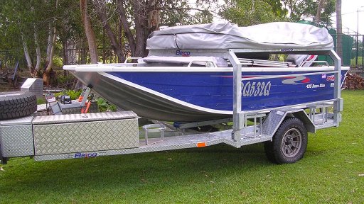

I’m not necessarily wanting to tow my boat down a trail. But to get it to a campsite down some forestry roads? Absolutely. I still think there are things that can be worked around. As an example, an electric trailer winch along w/ rollers on the back of the trailer would compensate for the higher trailer stance & wouldn’t make it necessary to back so far down the ramp. However, don’t think I can adapt this trailer. I’m thinking I will need to start from the ground up. Plus, I’m not the first 1 to think about this. I present to you this courtesy of the Overland pioneers down under...
That boat is a lot deeper hull & a lot heavier than my own. Independent trailer suspension. Better tires. Rollers instead of traditional trailer bunks. Electric load winch. RTT above the boat. They even have storage boxes near the tongue & you can see the mounting hardware for propane & jerry cans.
So, it can definitely be done. Now I just gotta figure out how to make it happen.

I’m excited to give it a go. I’ve started a diagram & parts list. I want to get a set of rock sliders & skid plates for my Subie still which is going to be a pretty big hit in the wallet.
I need a sponsor!!
