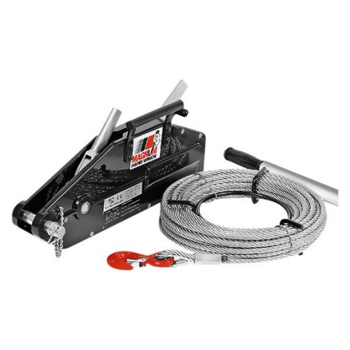

Maybe you should look into a More Power Puller come along. You can get synthetic line and pull up to 12000 pounds.

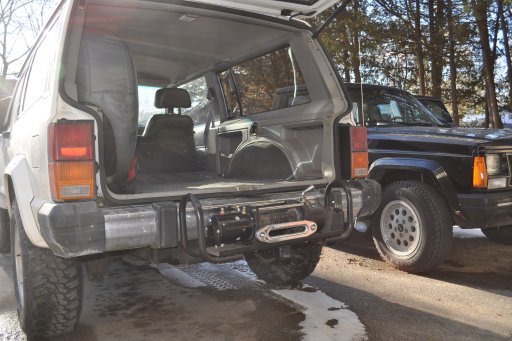

Like the others here I don't recommend the solution that you are considering. It doesn't appear to be robust enough for the job at hand. You might want to consider a trailer hitch mounted winch though. The idea is that you could have an appropriately sized winch attached to a portable winch mount that is designed to slide into a trailer hitch. When a winch is needed, you simply attach the winch to the trailer hitch and connect the winch directly to your battery via a preinstalled power cable or in a pinch, a long appropriately sized cable with alligator clips. You can use the winch to pull you out backwards or use pulleys to pull yourself forward (there are some YouTube videos that will show you how to do this. The advantage of this approach is that you don't have to drag the weight of the winch around during everyday driving, you don't need a special bumper, and you have the convenience of a properly sized winch when you need it. Downside is that you will have to make room for the winch in your vehicle when off-roading.

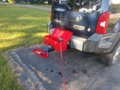

This will weigh well over 100lb and take two people to handle. My 4500lb winch box weighs 70lb with the leads and snatch block and shackles.
Get the More Power Puller. Those are great pieces and you can extract yourself pretty quick, but it does usually involve two people to do it safely since most of the time leaving your vehicle in neutral won't be a good option. I've done a few extractions with one and righted at least one vehicle with it. It's easier to store than the winch box too.

Receiver mount winch cradle, add a front receiver and your set to pull any direction.
I agree. I have a Superwinch 10,000 on a cradle. It's not for everyone and not the prettiest but it is a good option ... plus when not needed it sits in the garage. I've used it more for rescuing "barn finds" (i.e. - recent Jeep MJ that had ben sitting outside for 19 years). They are heavy as someone mentioned above. I replaced the 3/8" steel cable with a synthetic rope and that helped a LOT.

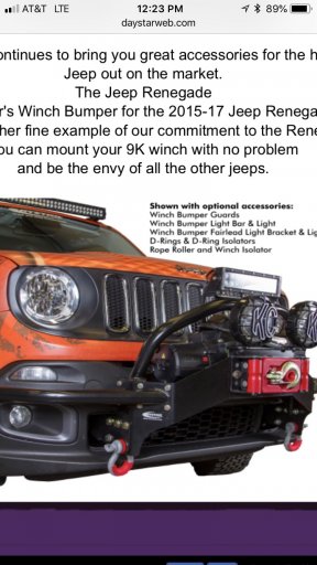

So I think I found what I’m going to do. Apparently the Daystar winch Mount can be removed when not needed, leaving only the recovery point brackets. These brackets attached directly to the factory recover hook mounts. This will allow me to take a winch when needed and not carry around the extra weight on a daily basis. Thanks to all that offered advice!

I think I would look hard at one of those cast iron come-a-longs if I could not have a winch.

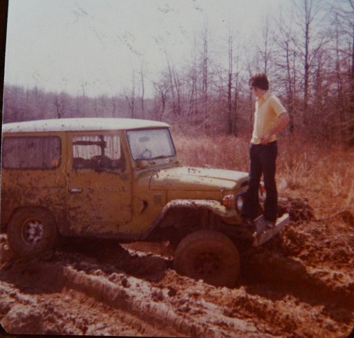

Winches are fine to have. I have one, but the question you must ask yourself is if you really have a need for one. Will you really get your rig into any situation that a pull is necessary.. You would be amazed at what human ingenuity, a pair of traction boards, a shovel, some rock piles, and a simple bottle jack can accomplish. You already have a high-lift and that alone will get you out of most anything. Years ago a winch was simply an un-affordable luxury for 99% of us and we got out of situations with only a couple of the aforementioned tools, primarily using shovels and wit. Here is a very old photo of me coming to a quick understanding that I was going to get very muddy as I dug out of this. Notice a very important fact. Even if I had a winch there was nothing to winch from. The nearest tree was at least a few hundred feet away. In a desperate attempt one might consider burying the spare tire with a winch line hooked to it, but that method rarely works and with an equal amount of shoveling you could simply dig the rig out.
I'm not saying, don't buy a winch, I'm only suggesting you think it through. DSC01093.jpg
