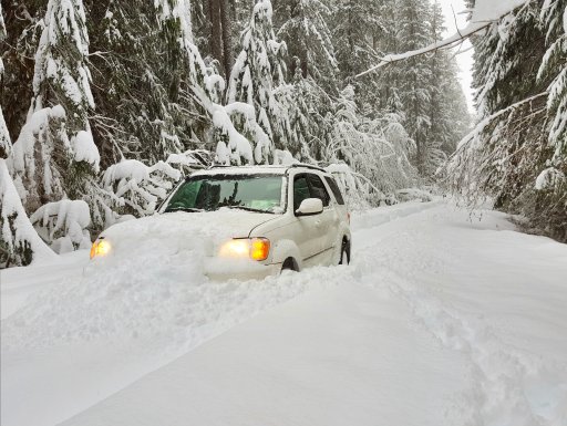

I guess I should have explained what I said a little better, I know the difference in a Trac, vsc , traction control ect ect . im just old school and dont like computers controling what im doing , in some situations and terrain and depending on the driver yes these systems can help with keeping in control . But for me personally and the places I travel in the PNW (wet , muddy ,snowy) I have never found traction control ,stability control or any computer controlled traction aid to work as well as good lines and just enough throttle to keep forward momentum and the tires cleaned out . Give you a good example in my sequoia even in 4 low with the t case locked I was stopped once the snow got to the bottom of the bumper , pulled the fuse for traction control and abs and kept on traveling for 10 more miles till the snow started coming over the hood and I decided to turn around . hdr_00503_0.jpg
But honestly whatever traction aid helps people get out and explore is awesome in my mind. Just be safe and don't rely completely on these systems and know how to turn them off completely if the go haywire ,you dont want to be in the middle of nowhere stranded because a sensor decides to quit working telling the rest of your vehicle it can't move anymore .
