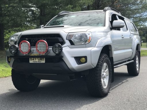

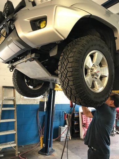

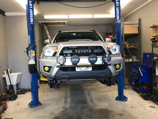

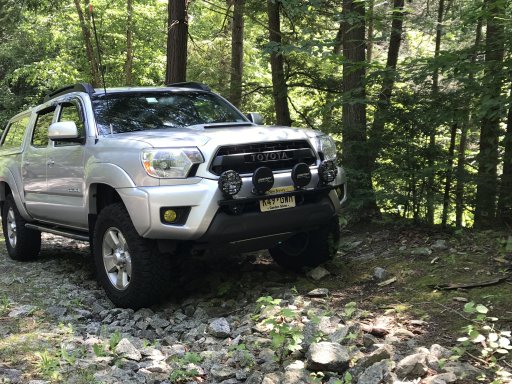

Did a lighting upgrade today. I wasn't impressed w/ the light from the IPF's and rarely used them as they weren't much of an improvement over stock headlights. Granted I didn't install the 100W bulbs, but these suckers are amazingly bright. I'm debating on getting two more to replace the remaining IPFs.

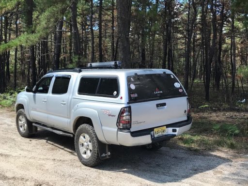

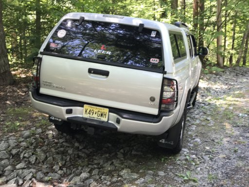

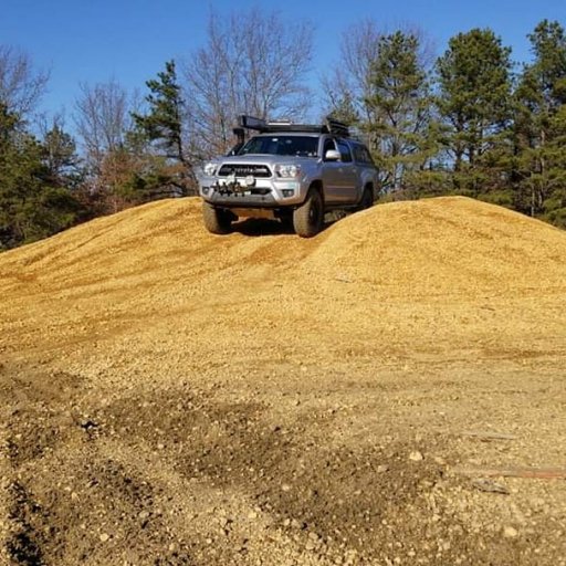

Few shots from the weekend. Just a hair over 800 mi. Other than rear leafs squeaking like hell..truck did very well.
View attachment 29246 View attachment 29247 View attachment 29249 View attachment 29250
My ome Dakar leafs squeaked a lot and solved it by separating them with a screwdriver and spraying fluid film between them. It's been a few weeks now without squeaking. I'm sure I'll need to reapply eventually, but it was quick and easy and fluid film is pretty awesome stuff so it should last awhile. I also sprayed it inside the frame rails after I drilled the holes for my sliders.
I actually used motorcycle chain lube and that worked pretty well so far.
