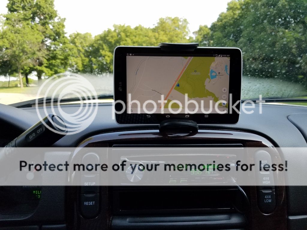

LG G-Pad 7.0 tablet with 64gb SD card - GPS, trail maps, dashcam, media

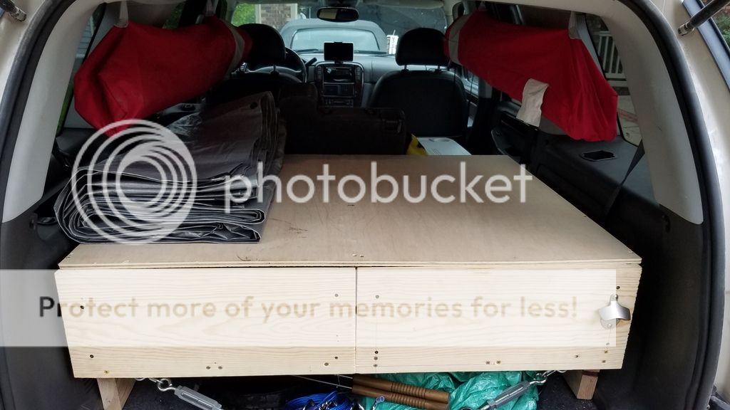

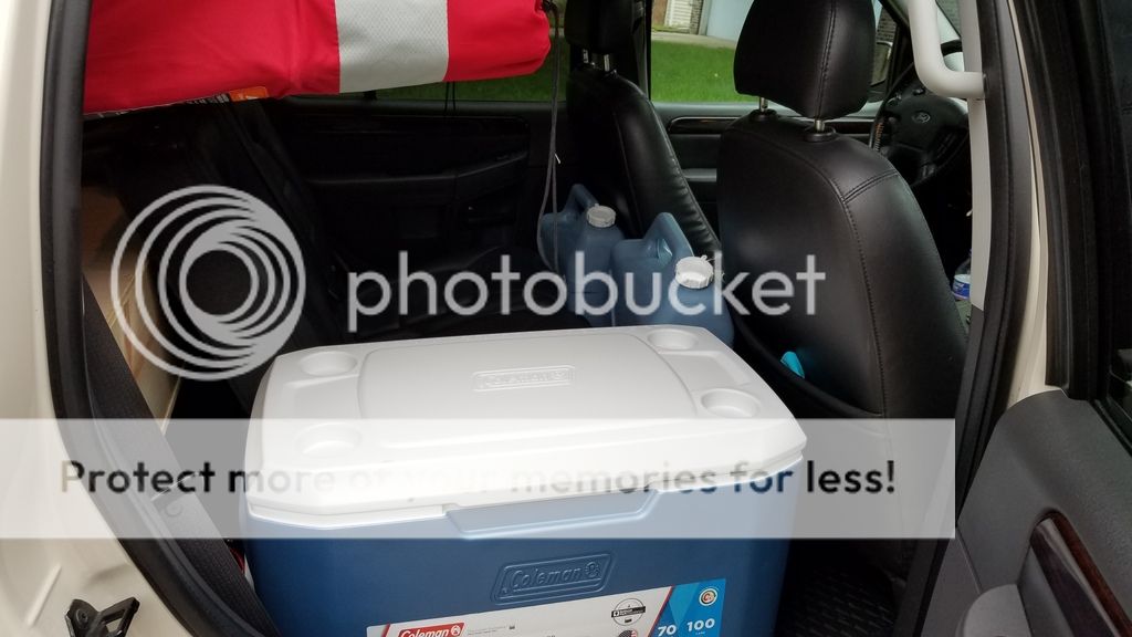

We started with the interior storage since we camp nearly every weekend and it's a way for us to figure out what works and what doesn't. We built a drawer setup with two drawers, each with 3 cu ft of storage. We removed the third row seats, which left a ton of room under the drawers for extra storage and I was still able to keep the 12" sub, because my tunes. Up above is a deck that will eventually have D rings (have em, gotta mount em) for securing an Ozark Trail camp kitchen (identical to the Camp Chef Sherpa but way cheaper) and a sliding mount for the fuel and water cans. The passenger rear seat has been removed and in its place we have a 70qt Coleman 5-day cooler. An Indel fridge may occupy that space at some point but for now the cooler works fine and it's entirely possible we won't even replace it. The only real motivation is not having to buy ice, though that in itself would eventually pay for the fridge.
I haven't bought slides for the drawers yet and the whole thing still needs painted, but overall it's very useable and seems to work well for us. The best part is the truck is always packed. We get ice and whatever groceries we need, pack some clothes and hit the road. Easy peasy.

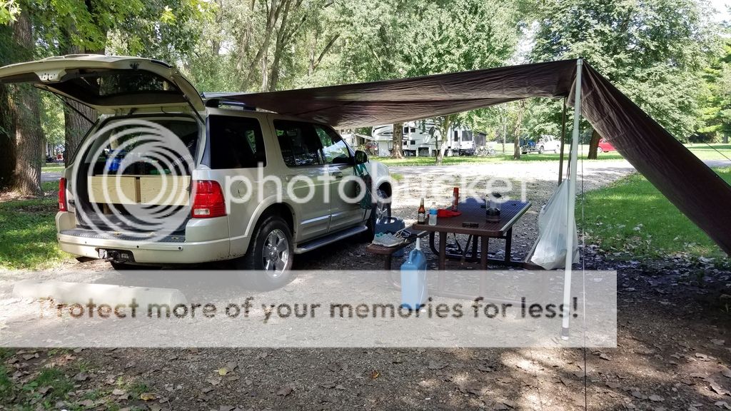

We've also started a DIY awning using a 10x20 tarp that can also cover our tent if the weather turns super shitty, and poles built from Sch 40 PVC. The poles are kinda heavy so we're looking for lightweight alternatives, but overall the setup works well. I'll get some pics of the setup tomorrow but for now here's some pics of the Explorer and where we're at so far:

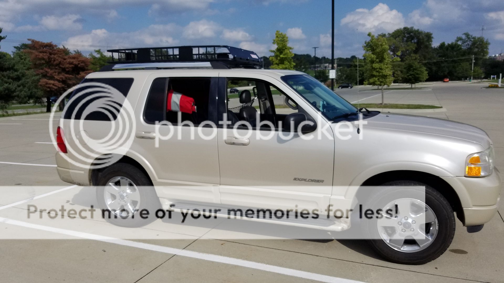

Went to the local pick n pull to look for some cross bars for the roof rack. For some reason a lot of 3rd and 4th gen Explorers didn't have them, despite having the side rails. Anyway, found just one 3rd gen on the whole lot and it happened to have the cross bars. Winning! Got them mounted, now I just need to get a basket up there. Sooooo looking forward to that one, we'll be able to throw bulky stuff like the chairs and tent up there.
We were supposed to have thunderstorms but we got sunshine and humidity instead. Threw the awning up anyway, or half of it. Didn't see the point of putting the whole thing up when we weren't even going to put the fly on the tent. Haha.

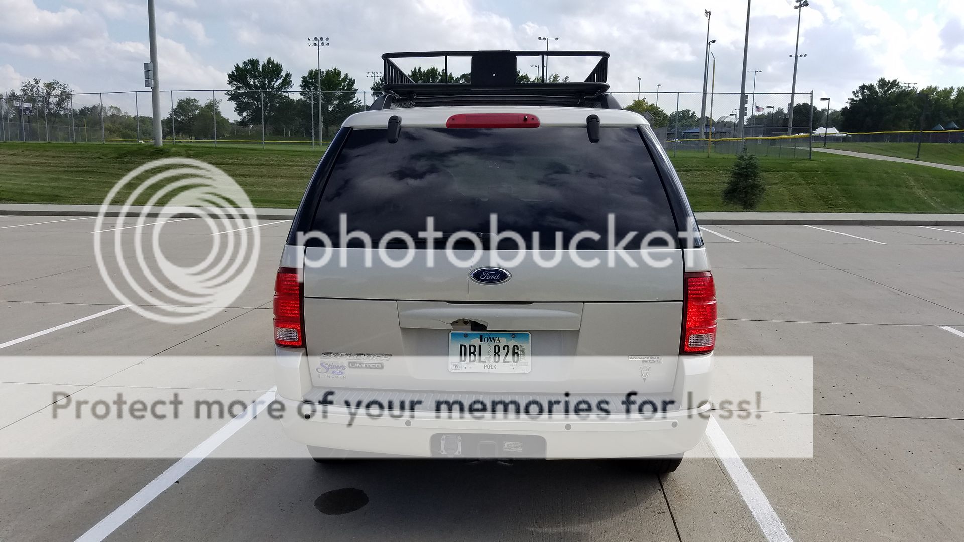

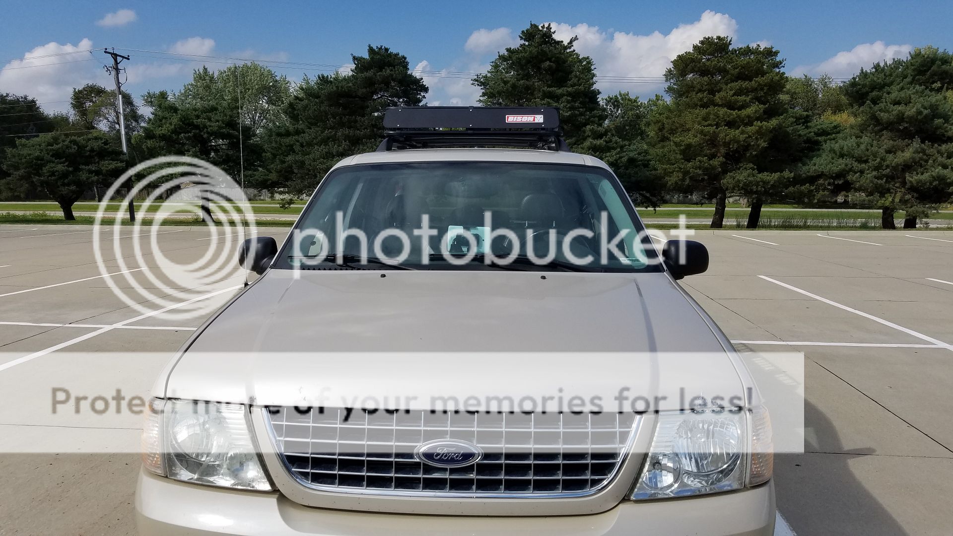

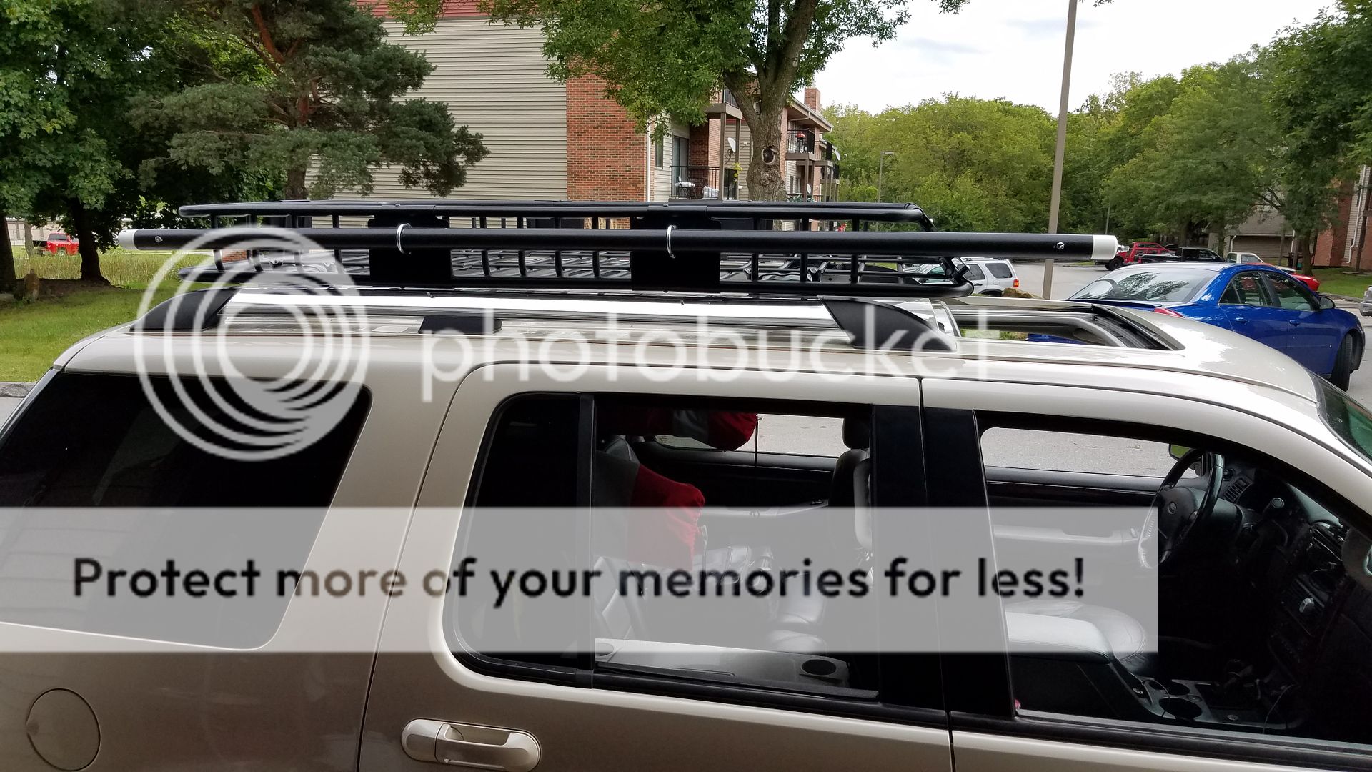

The roof rack and Keeper both came yesterday so I got the rack mounted up this afternoon. I went with a Bison rack and it seems like it should suit our needs. I did read that the Bison/Curt/Arksen rack suffers from horrible rust issues as a result of water getting inside the tubing. To remedy this I sprayed the rack with bedliner and sealed all of the seams with black RTV.
I actually think it looks pretty good, length and width almost look like it was made for the Ex haha.
I need to fab up some mounts for the awning but other than that, this is it for this year. Once the baby is born and we get moved into a new place I'll be able to put money into her again. Tires, skids, sliders, lift, lighting... So much to do.
