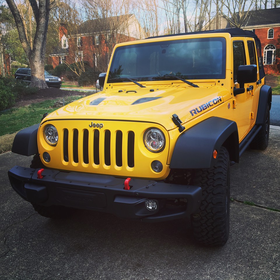

Before we go into that, here's a few pictures of Rube when he was just a pup. Oh, by the way, I name my vehicles. Some my find that weird, but people name boats and planes, so why not vehicles? Also, in case you're wondering, I use SmugMug for photo hosting (it's awesome).
Alright, enough babble... Time for some pictures!
Rube, me and Lana, my 2007 BMW 335i that I traded for Rube. She was a great car, but I've had a lot more fun with Rube. I was living in Atlanta at the time and drove down to Savannah to pick up Rube.
The dealership was the worst possible experience possible and I ended up spending 8 or 9 hours in negotiations (after having "pre-negotiated" everything over the phone). I was expecting to walk in, sign paperwork, and be on my merry way. WRONG. However, I ended up getting a better deal (and the dealer ended up giving me most of their hold back) because they screwed me around. Don't try to screw a guy that knows the car business. However, I ended up leaving at 9PM and having to drive through some torrential rains and extremely high winds almost the whole way back to Atlanta, as a storm was ravaging the entire East Coast.
A quick shot of Rube sitting pretty in the parking garage when I got him home.

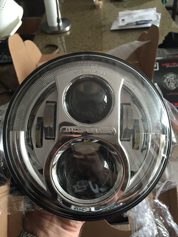

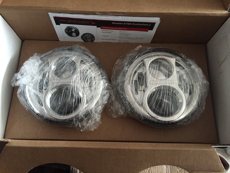

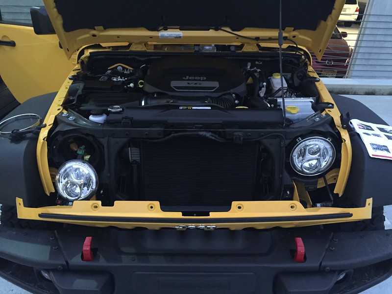

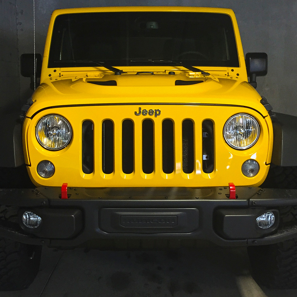

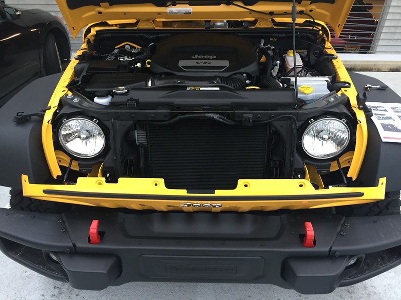

Alright, onto the mods! After driving home from the dealer through almost 3 hours of torrential rains, I quickly realized the stock lights were not only inadequate, but actually a safety hazard.
So, the first modification I made was to the headlights. I replaced the stockers with JW Speaker 8700 Evolution J LED headlights.
The lights are designed and built in the USA and carry a lifetime warranty. The build quality is excellent, the installation is easy and the light output is fantastic for this type of light. It's not quite the same as the light output from a true HID, like I had in my BMW, but it is definitely adequate.
The only thing I will mention for those wondering - if you live in an area with a lot of snow, road prep and freezing temperatures / ice storms, I would look into the heated version of the Truck-Lite, as LED headlights in general do not put out much heat at all and thus wet snow (like you see on the East Coast) is likely to stick to them. I would also recommend using a product like Plexus to coat the headlight at least a few times a month leading up to and during winter to make the lens shed liquid better, thus reducing the likelihood of ice or road prep buildup.
Here's a few shots of the lights themselves prior to install.
An easy plug & play install. I later circled back and installed the Mopar horizontal adjustment screws as well.
All buttoned up!
And yes, the paint color does change with the lighting!

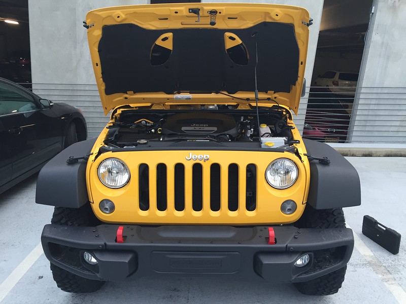

I didn't actually do the install of the hood lock, I had it done when I was having factory fluid levels checked (if you buy a new JK/JKU, I would recommend doing this, as many have noticed the fluid levels are very low from the factory - my transmission fluid was low, everything else was fine).
The boys at the dealer did it for me for free (I don't own a rivet gun and didn't want to buy one for installing a few rivets); they had never installed one so they used it for a "learning example." :)
I "supervised" the install because I had read the instructions and they hadn't, but it was a 5 minute install, just lining up the lock and riveting it in; pretty straightforward.
I don't have any pictures of the install, but here's a picture that shows the hood lock (taken when I was starting the install of another mod, but that's a story for another post).

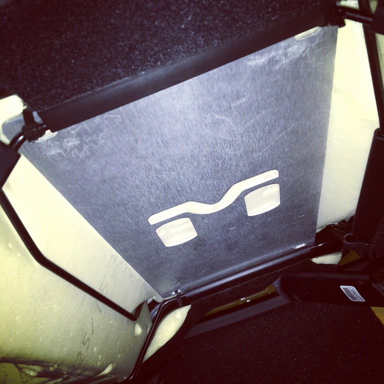

The next mod I made was another easy install - the MetalCloak Center Seat Support for the rear seat of the 4-doors.
After sitting on the center seat before and after, I can say this makes a huge difference. Without it, the center rear seat feels like you're sitting on a piece of foam that was placed on top of a 5 gallon bucket with no lid. With it, it feels like you're sitting on a proper seat. High quality, inexpensive, fantastic results. Gotta love it, right?

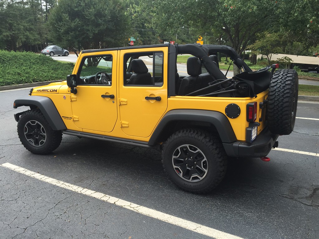

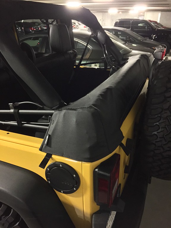

Another early mod was the Mopar boot for the factory soft top.
As you can see in the picture below, Baja Yellow looks good with the top dropped, but the top looks a mess even when you take the time to fold it back carefully...
Well, Mopar boot for the soft top to the rescue!
I'd guess most of the overland community that are using Jeeps as their platform are running hardtops, but if you're running a soft top and like to drop the top back on occasion, this is a great way to keep the top from flapping around. It also doubles as a way to store the top if you remove the soft top seasonally.
Reactions: toxicity_27

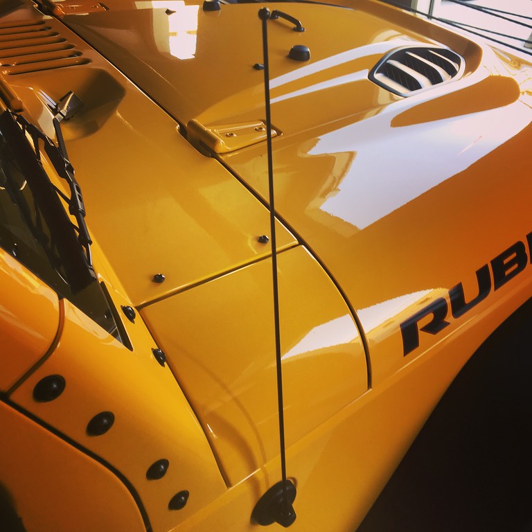

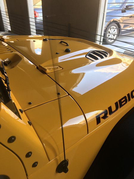

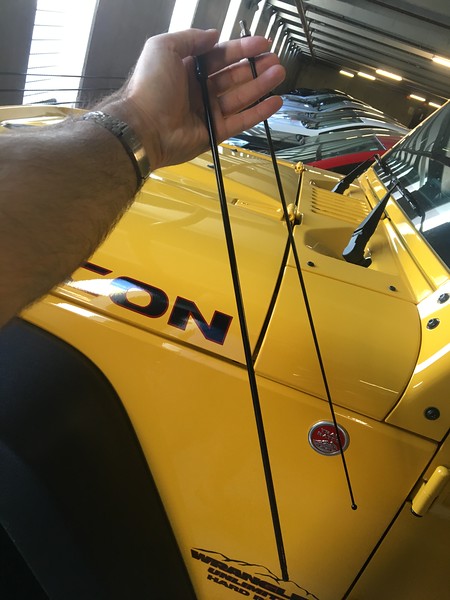

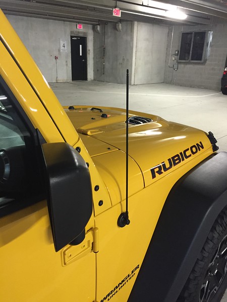

Another quick/easy mod I made early on was to ditch the tall factory antenna for something shorter. The intention here was to keep the antenna low, so that it did not get caught on low hanging foliage and "whip" back into the windshield.
The antenna I initially selected was made by AntennaX, as seen in the picture below. File this under "Mods I Regret."
The reason I was not happy with this mod is threefold. First, the antenna was perfectly round top to bottom, so there was not really a good place to get a small wrench on the thing and really tighten it down. Second, the antenna was completely rigid, and because it couldn't be tightened properly or flex with the vibrations of the Jeep while driving, which resulted in it constantly working itself loose. Super annoying. Lastly, I just thought it was ugly (wasn't really sure what to expect when I ordered it, as the product pictures weren't great).
I quickly replaced the AntennaX brand antenna with an "AntennaMastRus" spring steel antenna off of Amazon. It was cheaper and higher quality than the AntennaX brand. It was also spring steel, like the factory antenna, so it had a little flex to help deal with vibration. Here's a few pictures.
Side-by-side comparison: Antenna X vs AntennaMastRus
Much better aesthetic.
Spring steel FTW!

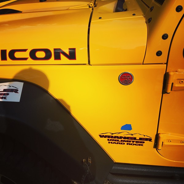

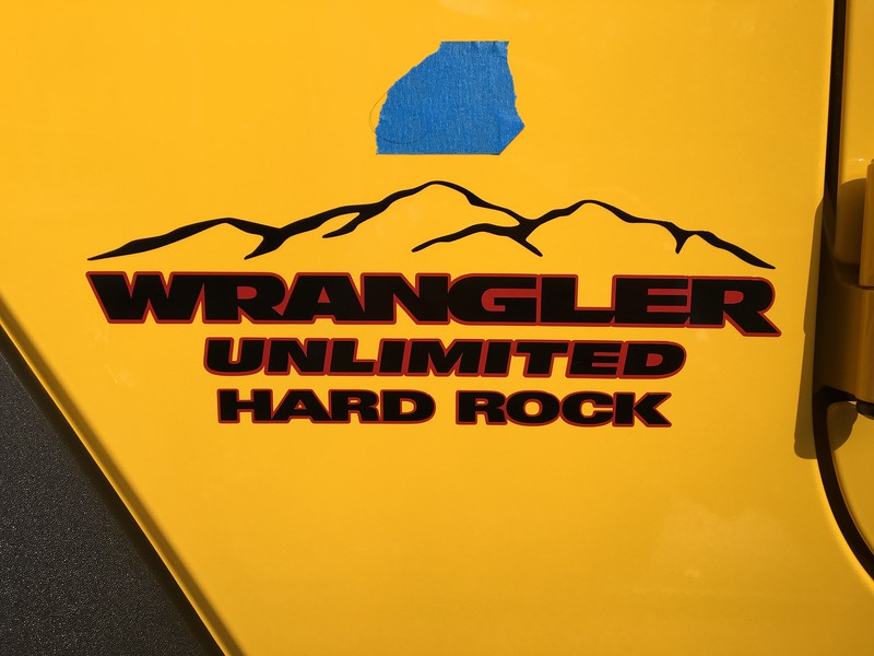

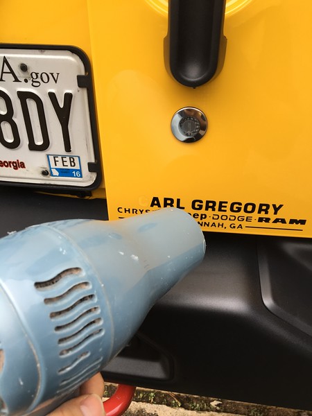

Also, a couple of purely "fun" cosmetic mods that I did the first time I did a full wash, wax and detail after buying the Jeep...
Removed all trace of the horrible dealership... Side note: It's a pet peeve when dealers put decals on vehicles - use a cheap plastic license plate frame, so we can rid our vehicles of your name / information fast!
(And yes, I used to live in Atlanta, before moving to Denver)
Replaced the "Wrangler Unlimited" decal on the sides with a custom "Hard Rock" decal (5 HP gain).
(The blue masking tape was used as a height guide)

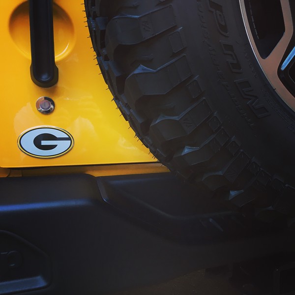

Added a Green Bay Packers "G" (Green & Gold 'til I'm dead & cold!)
Gotta make the vehicle yours, ya know?

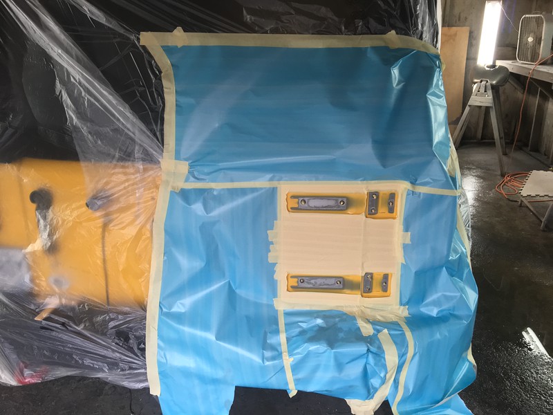

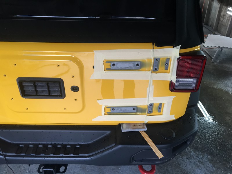

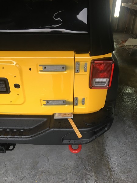

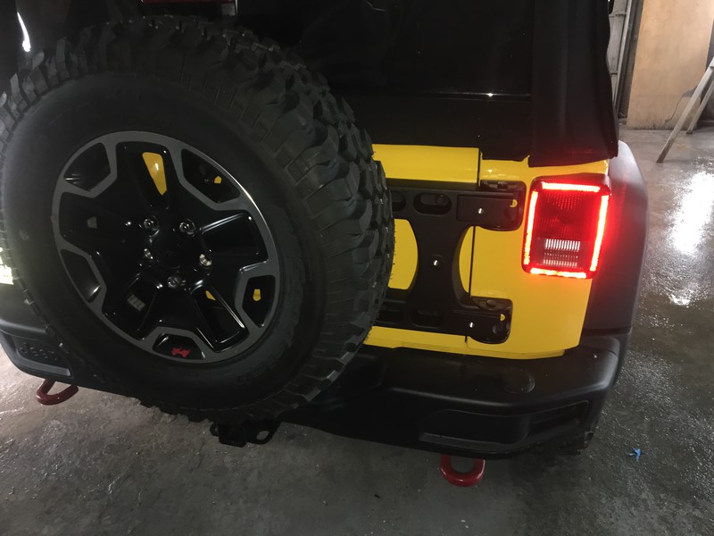

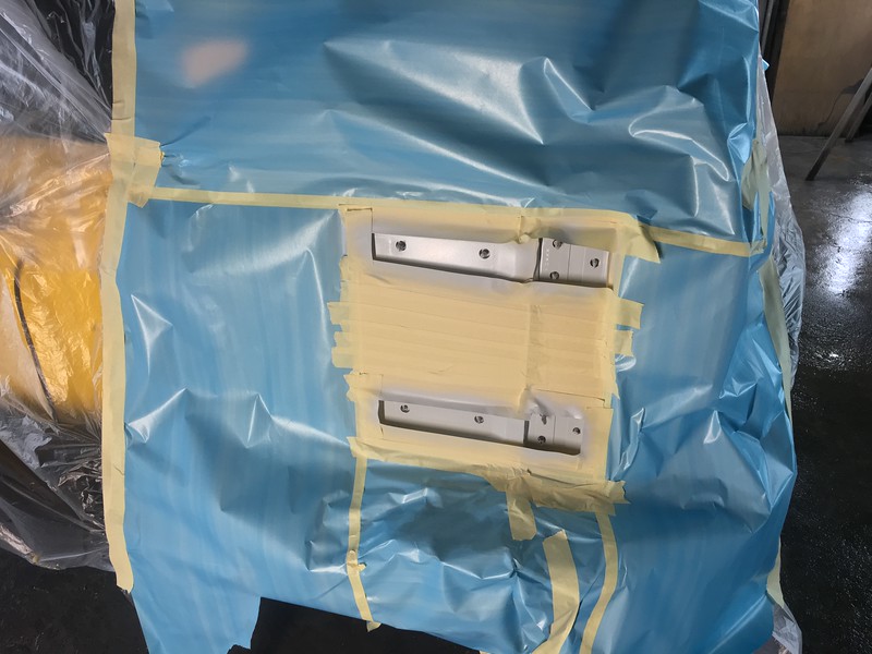

The next mod is also one that I file under "Mods I Regret," but unlike the AntennaX where I just didn't like it at all from an aesthetic or design standpoint, this upcoming mod just ended up not meeting my needs. It's a GREAT product, and I was really happy with it, but it just did not function the way I needed it to out here in Colorado.
The mod? The TeraFlex HD Hinged Carrier with Adjustable Spare Mounting Kit and Third Brake Light Extension Mount Kit for HD Hinged Carrier... Hey, TeraFlex... maybe have a less technical guy name you products? That's a mouthful!
So, with this mod, you must remove the factory hinges, as the HD Hinged Carrier portion replaces them with a beefy forged aluminum piece that is powder coated for corrosion resistance. Speaking of corrosion and resistance thereto, Jeep doesn't paint under the factory hinges... so I did!
Step 1: Shim passenger side of the tailgate, remove factory hinges, clean up tailgate.
Step 2: Start masking off the area to be painted
Step 3: Mask some more!
Step 4: Primer! In this case, we used an epoxy primer to really seal things up but actually got the primer base color wrong - should have gone with something a little darker, but since the area was masked so well, I'm not really concerned as there was no overspray to speak of and everything painted would be covered by the TF carrier and by the stock hinges if I ever put them back on the Jeep (*dum, dum dum* foreshadowing)
Step 5: Lay down the color (forgot to take pictures of that, so moving right along...)
Step 6: Install your TF HD Hinged Carrier!
Looks great! A couple of things. I ran the HD Hinged Carrier portion of the super long and extremely detailed technical product name listed above with the stock carrier for a while (this is possible with the TF carrier). I installed the adjustable portion of the kit and the 3rd brake light extension after my lift and tires were on (shut up, Jason, you're giving everything away).
This mod will be revisited soon... Something more functional takes its place...
