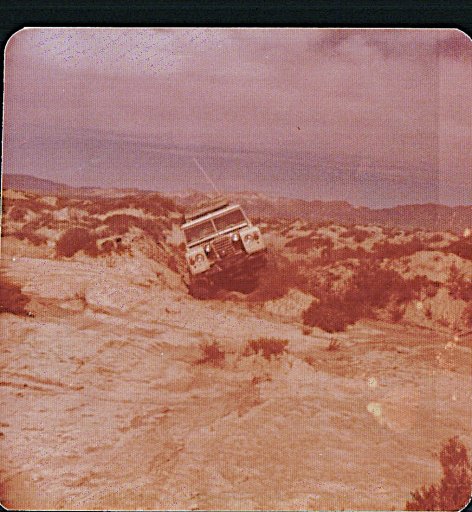

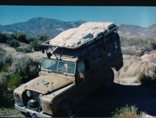

I've spent some time in the Black Rock in the 70's and 80's. Staying mostly on roads isn't too bad as long as it's dry. It's going off on those 2 track off main trail that can be fuel eaters. I carried 2 5gal cans and used both in 4 days of exploring in a 1973 Land Rover Series 3 with a 4cyl petrol 2.25l engine and a 12 gal main tank. Later trips in a 1967 Land Rover Series 2A with a Chevy 6 swap, still a 12gal main and 2 5gal cans. Filled up in Empire before heading into the desert.
You know your vehicle and driving style best so ultimately your decision, Me?, I'd take another can and not worry.
