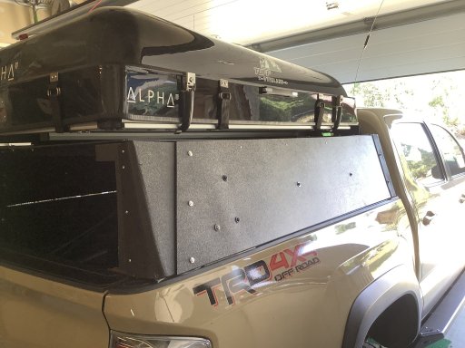

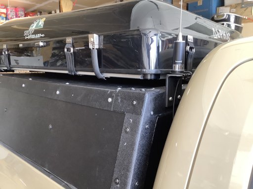

I have used HDPE sheet panels for a few projects over the years and learned a few things. On a workbench work surface project, I learned that a big sheet will warp/buckle when secured flat and it gets hot. On a truck tailgate I would suggest installing the panel in the heat of summer.

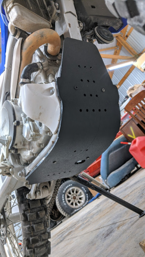

I also built a skid plate for my Yamaha WR out it it.
I struggled producing a very clean edge with the stuff. For a power tool, I found a jigsaw on low speed with a plexiglass blade worked okay. As stated above, most power tools will melt the HDPE instead of cutting it so take it slow. If you are cutting a straight line, I found by using a basic utility knife you can score the material several times and bend and crack it for a decent edge. A rough edge produced by any method of cutting can be cleaned up using rough to fine sanding sponges.
