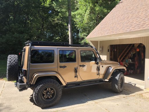

I’ve got the rhino roof rack. http://www.rhinorack.com/
It is a little difficult to attach the RTT, but worth the low profile. I fit in my 8’ garage door. IMG_0722.JPG

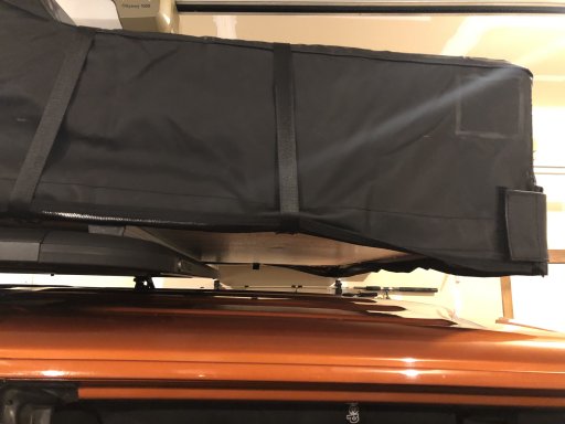

Only a handful of miles so far. I'm still working out a few solutions. I got the idea from TrailRecon:

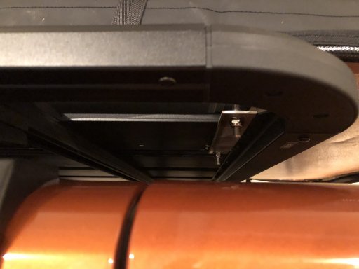

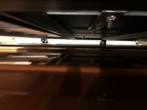

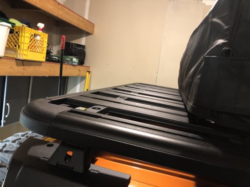

I had to drill new mounting points for the sliding rails in order to go the opposite direction on the rack. I also cut the sliding rails to fit. I was lucky that SmittyBilt messed up and sent me extra set of rails, I was less worried about messing up. I made my own brackets to span the rhino rack's decking members. They are made out of SS.
Good eye- seeing that it overhangs in the front. The original mounting option was even with the rear. I am planning on a trip in May on the TAT. With that in mind, I wanted to carry additional fuel and additional equipment. I left about 13" in the back to attached various items. The front overhangs 18". So far no issues with the overhang.IMG_0726.jpg IMG_0728.jpg IMG_0729.jpg IMG_0730.jpg
Good eye- seeing that it overhangs in the front. The original mounting option was even with the rear. I am planning on a trip in May on the TAT. With that in mind, I wanted to carry additional fuel and additional equipment. I left about 13" in the back to attached various items. The front overhangs 18". So far no issues with the overhang.View attachment 79506 View attachment 79507 View attachment 79508 View attachment 79509

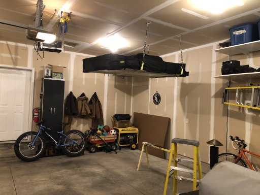

I also forgot to mention that the other reason for this style of rack is that it allows me to take the hardtop off and store it. I built a lift in my garage that lifts off the top and stores it. My hope is that the hardtop and RTT will come off in one piece and that it can be stored together. Ignore the messy garage.

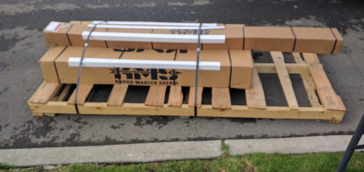

I have the KMS Kargo Master Congo Rack and it works excellent for my application and my budget. I added the Catwalk across the cowl and the side steps at the door hinges to make it easier for me to access the tent during setup and takedown. View attachment 82503View attachment 82504
Funny, I got yesterday the delivery of a KMS roof rack and already ordered a tepui tent.
Do you know what is the weight limit of the cat walk?
