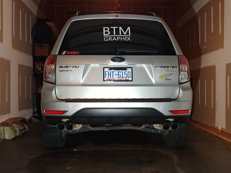

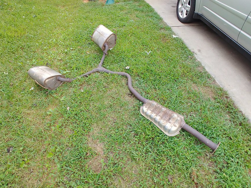

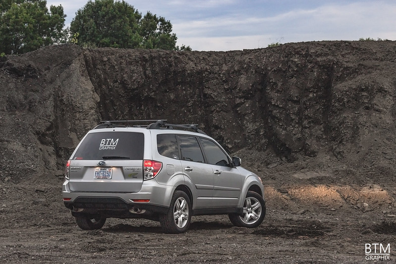

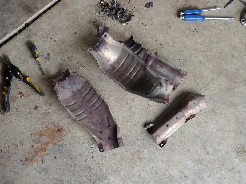

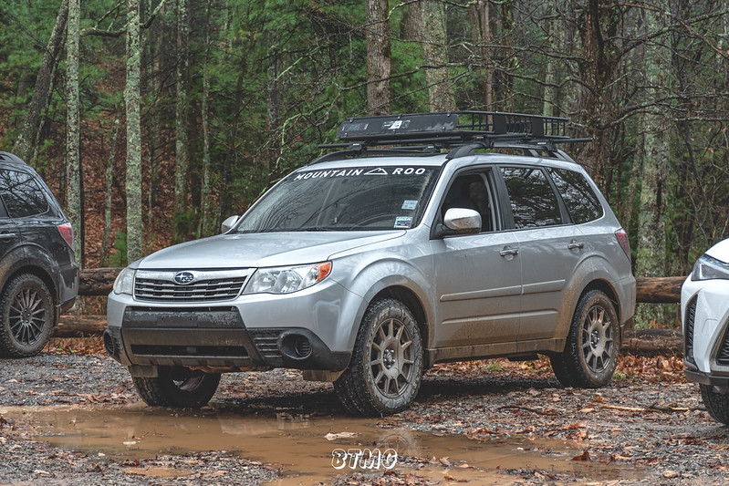

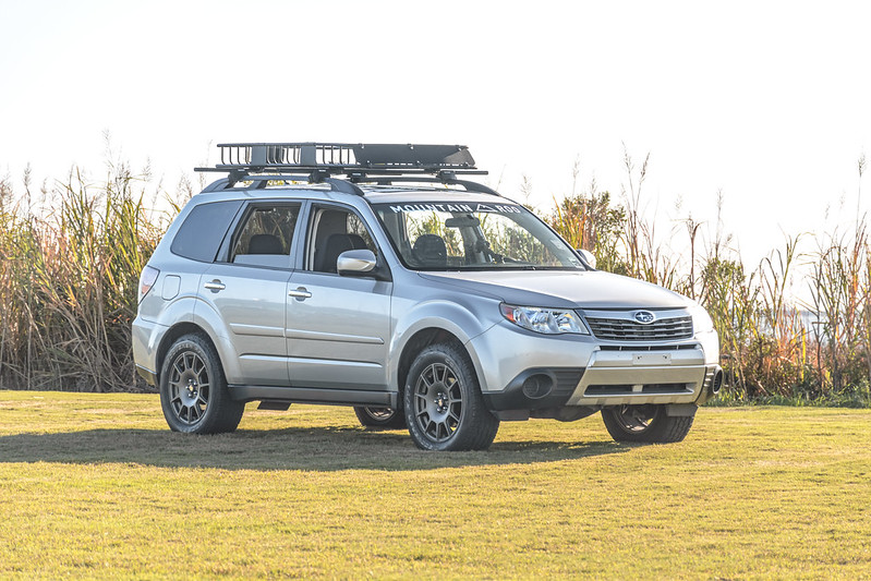

Fast forward a 1.5 months later and I started modifying the Forester. The great thing about Subaru, is a lot of models have interchangeable parts. My generation Forester shares almost everything in common with the 08-14 Impreza/WRX/STi and in some cases 15 - present WRX/STi. I went ahead and had my exhaust taken care off since it was pretty much a rusted hunk of metal. The amount of rust falling off the hangers and around the flanges was ridiculous. The SH forester exhaust can be swapped out with the 08-14 WRX/STi sedan models only and is a direct fit from the cat back (or where the downpipe would be on the turbo models). It gives the car a nicer sound to it but because of the equal length headers on the NA cars I dont get that nice Subaru rumble, but cold starts are still pretty cool. I got my replacement exhaust from my friend Corey and his 2013 STi sedan. Another problem area were the heat shields around the stock manifold. They tend to rattle...a lot...and it doesnt stop. I went ahead and had them all cut out and removed.

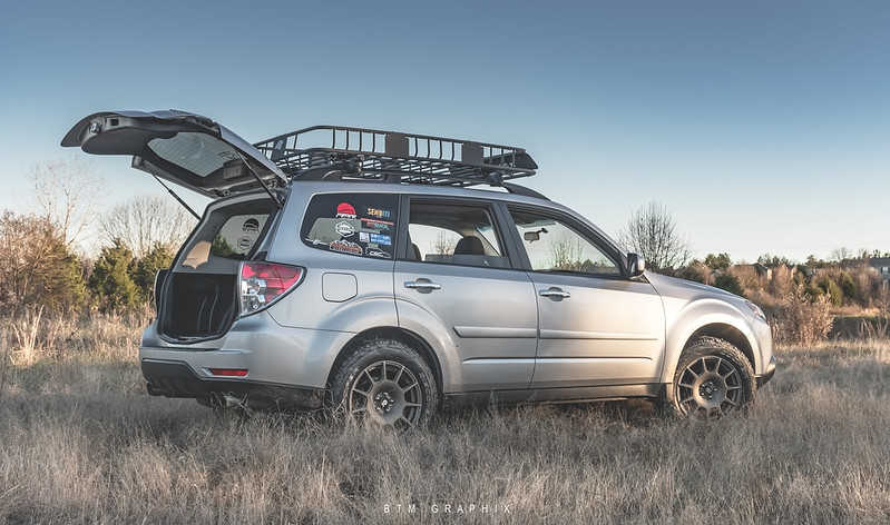

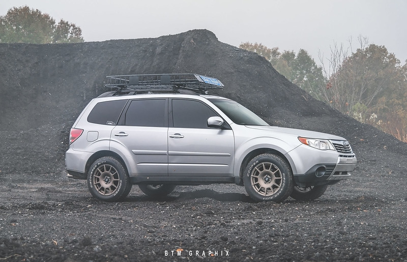

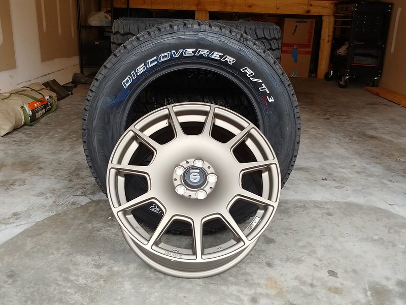

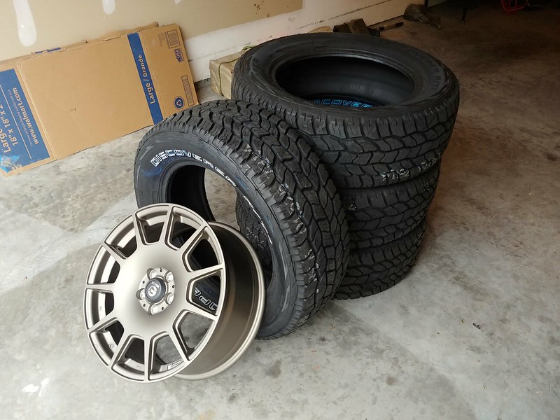

A week later I had ordered my wheel and tire package. I did countless hours of research as to what would fit and what wouldnt on stock suspension. I wanted a wheel brand that was proven and a good tire brand the performed well but didnt sound like a helicopter going down the road. I ended up going with some 17 x 7.5, +48mm Sparco Terra in matte bronze and for tires I went with 235/60/17 Cooper Discoverer AT3s. The setup barely fit inside the wheel arch. The rear fender liners had to be removed in order to fit the rears on but the fronts remained on. I did have minimal rubbing but only at full lock. The Coopers were great and I would recommend them to anyone. They were quiet for daily driving, handled phenomenally in the dry and wet, cut through dirt and mud but werent too grippy for some snow hooning in an IKEA parking lot.

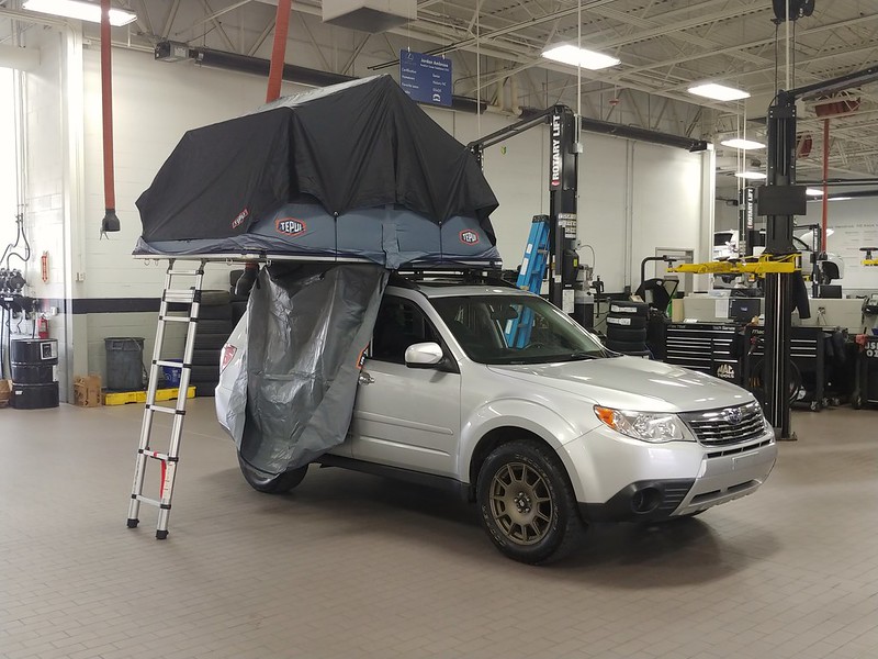

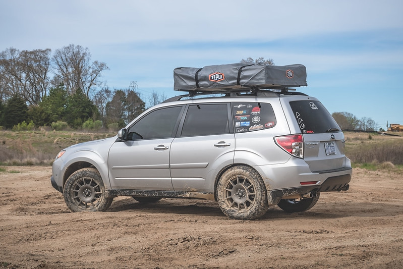

February 24, 2019

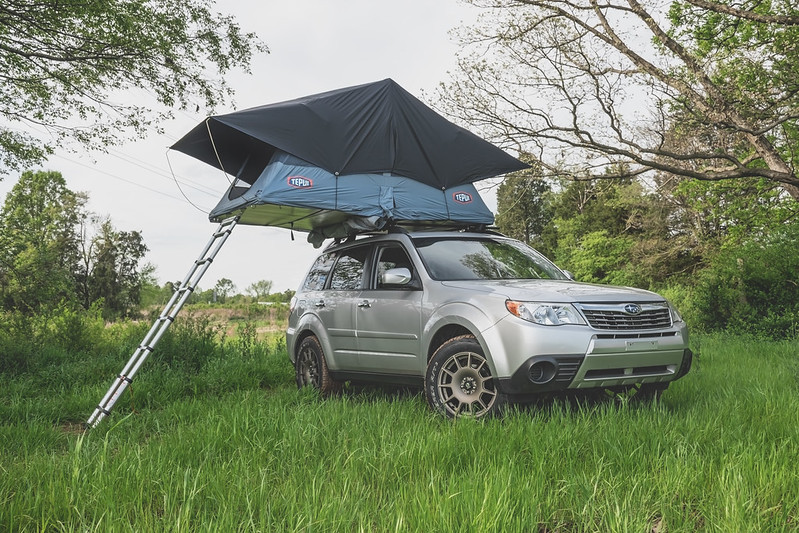

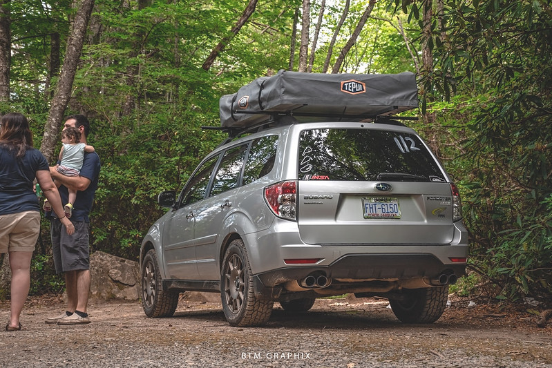

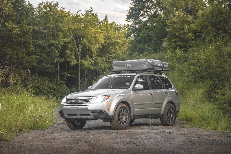

I used my tax return to purchase a RTT from Backcountry.com made by Tepui. The model I got was the Kukenam 3 Baja Series in Blue/Grey and got it on sale and shipped to my job for $1000. The setup was pretty straight forward but I kind wish I had some help. I started the installation after work in the shop at 6PM and didnt finish until 8 something. Luckily I had some people in the shop to help me lift the tent on top of the car. I also went to the REI and picked up some longer round bar rails (becuase I though I would need them for the tent but I didnt) but they've been on the car ever since.
I ended up selling the tent later down the road because it wasnt ideal for the stuff I was doing at the time. It became more of a hassle if anything. I would like to do another one a few years from now but on something like a trailer setup or a clam shell for super fast setup and put away.

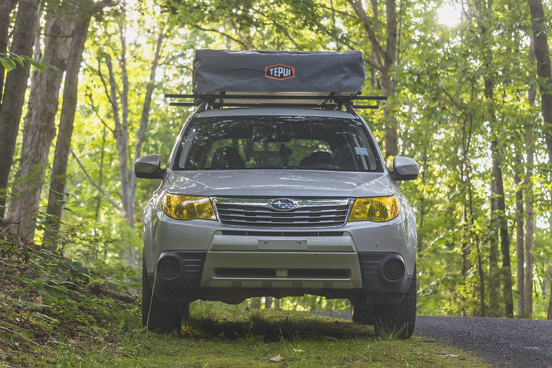

(May, 2019)
I had the headlights wrapped in yellow film which looked great imo and helped cut through fog and dirt but would not pass NC inspections. The headlight bulbs were replaced with MOSTPLUS LED bulbs which look similar to 6k HIDs. They were $50 on Amazon.

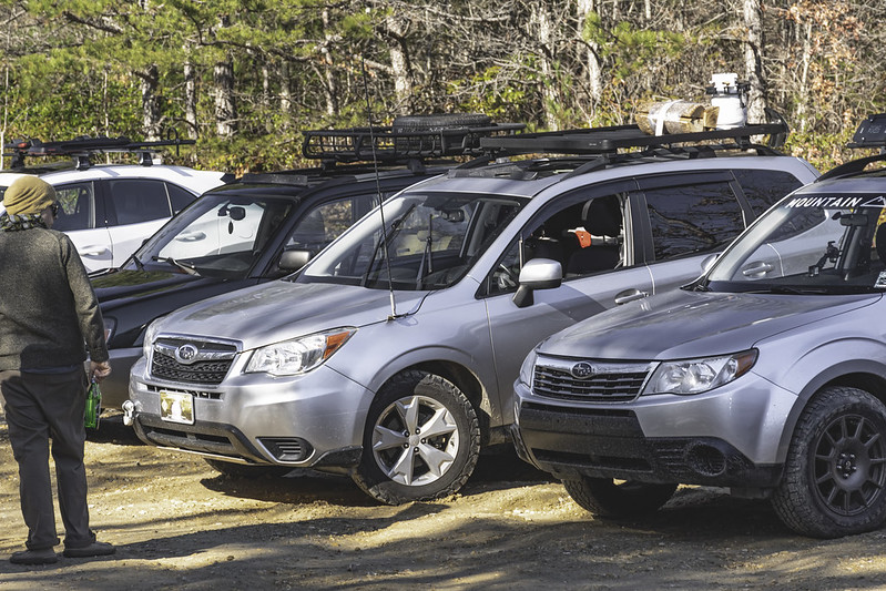

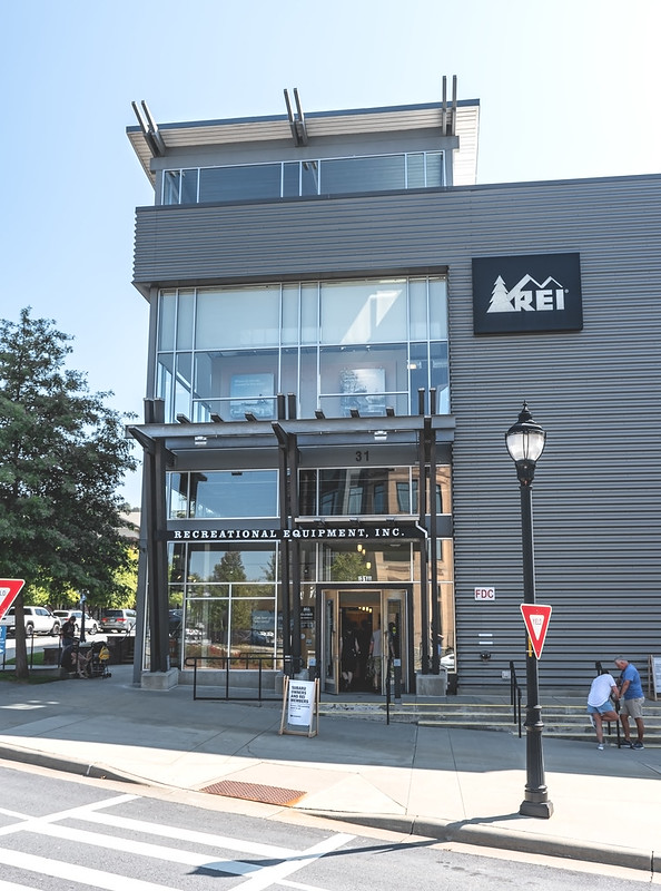

Got together with some of the Mtnroo North Carolina members and drove up to Asheville. Subaru was doing their Road Trip Tour to REI to feature the new Ascent. I dont travel to Asheville a lot but my god I have never seen so many Subaru's in one place...it was mind blowing. Weren't there for too long and after we had grabbed some lunch we drove West towards Cherokee to go and drive Heintooga Round Bottom Road.

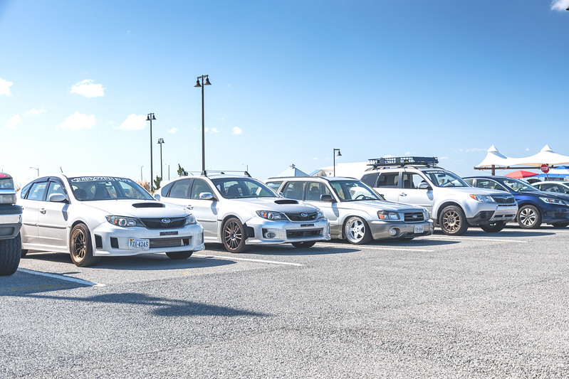

I took a trip to the OBX for a car show ran by Sumospeed. They are a car club/movement located in VA Beach and they host some awesome events. This event happened to be in Kill Devil Hills and we were only there for a few days so I wasnt really able to visit and explore a lot of areas. Many years ago my dad has a beach house out there and the year of Hurricane Sandy pretty much destroyed everything but before that when I had my Xterra, I drove up and down the OBX, includng Corolla/Carova. Unfortunately, we had a storm a month or so prior to us coming out for this event that closed the beach access in Carova so I wasnt able to take the Forester out. Bummer. I also had sold the RTT because it wasnt as great as I thought it would be and became more of an inconvenience.

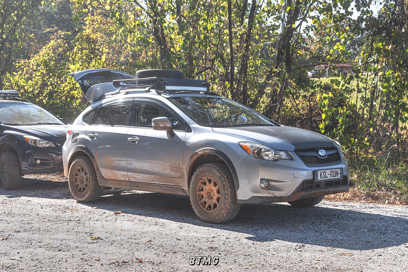

The second trail ride was about 30 minutes south of Johnson City, TN. The event was organized by Mtnroo NC and our tour guide was a guy named Richmond local to the Unicoi/Erwin, TN area. He took us up the Pinnacle Mountain Fire Road where there were plenty of car and ATV trails. Our total group had about 7 rigs. Before getting to the meet-up spot, I met my buddy Matt in his Lexus UX somewhere near Morganton, NC. Matt's 2019 Lexus UX is pretty rad and features the RS-R Jouge coilover suspension on a set of Falken Wildpeaks. You'll see him a lot in some of my pictures. Its the little FWD that could! I cant wait to see what he does with it...maybe some R&D with LFD_Offroad.

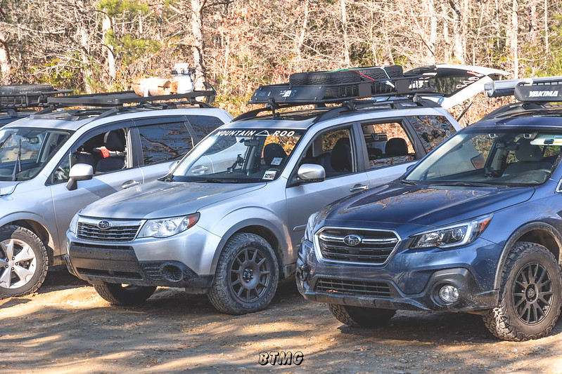

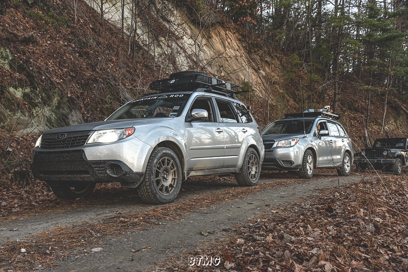

December 15, 2019

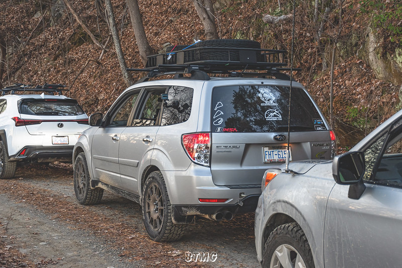

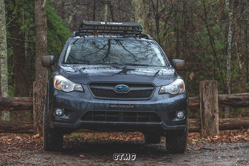

Mtnroo NC got up for another trail ride, this time up Old NC 105 and then down Maple Sally. Old NC 105 is for the most part a maintained gravel road on some parts. The south side of the trail starts near the Lake James area and travels north towards Linville, NC. There are plenty of trailheads, camping, overlooks, etc along the way. The road snakes along the Linville Gorge which offers spectacular views either from the trail itself or from Wiseman's Overlook. Toward the top of the trail is Linville Falls, which I still have not been to.

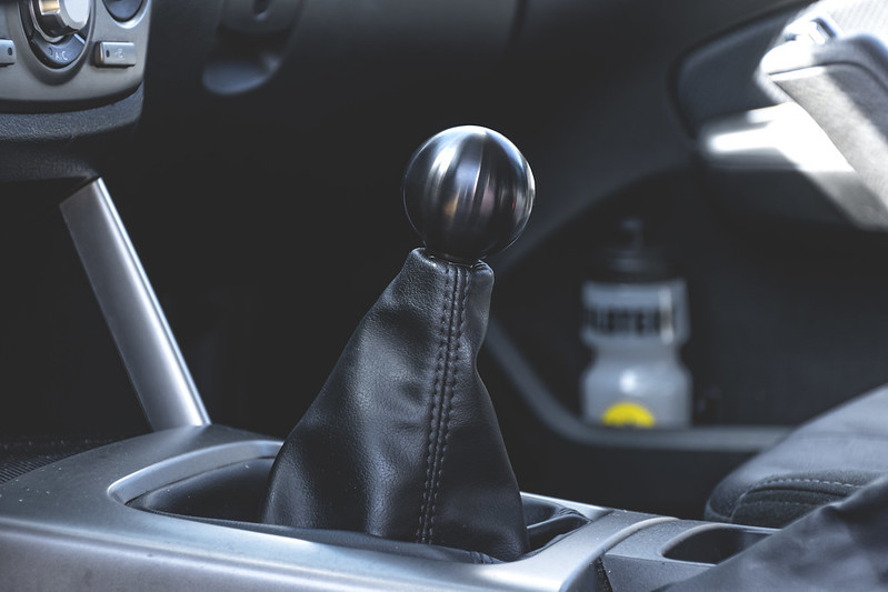

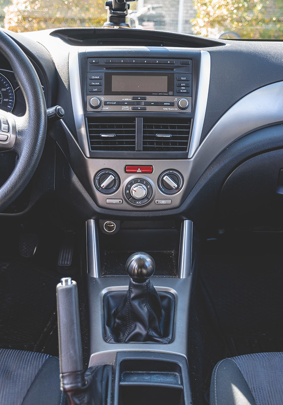

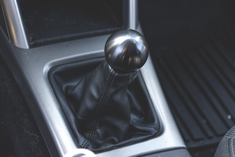

With all of my past cars/builds, which were all manual, I always got a weighted shift knob. It made every throw really solid, the shape feels great in the hand, and usually looks good. At some point in the future I would like to have a custom engraved knob made but for now this one works just fine. I picked up this Blox Racing knob and at a weight of 490 grams its decently heavy.
From their website
"The BLOX Racing 490™ Spherical shift knob is CNC-machined out of high grade, billet stainless steel and then custom-weighted for maximum performance. Each shift knob is then PVD-coated for superior hardness and wear resistance."
I've bought crappy knobs in the past where the coating or finish didnt last but so far this thing hasnt seen any aging, so its good in my book.

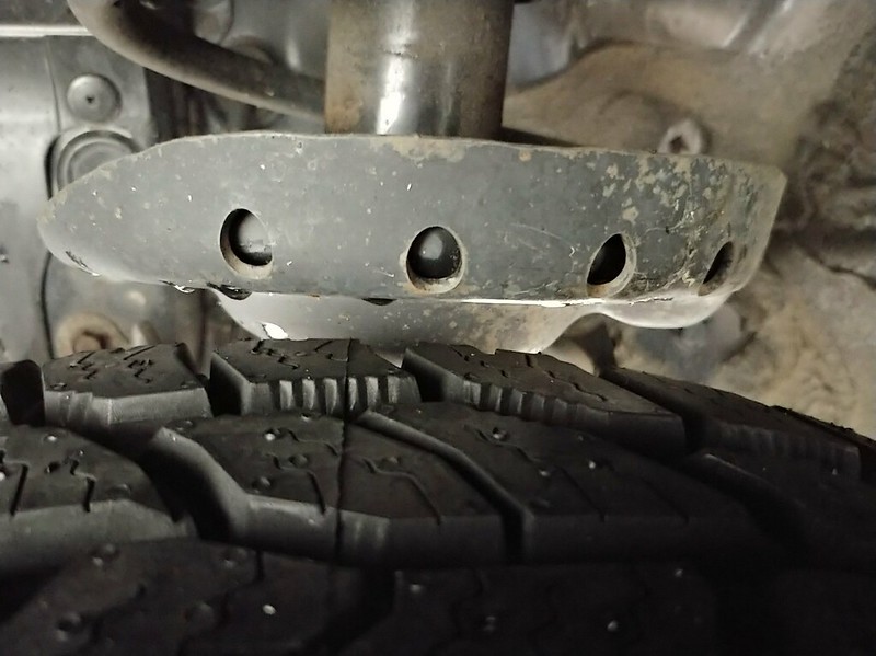

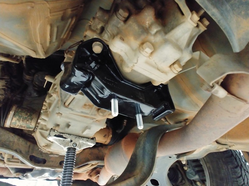

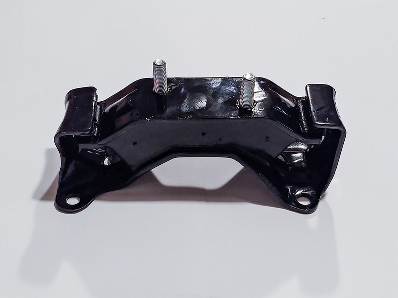

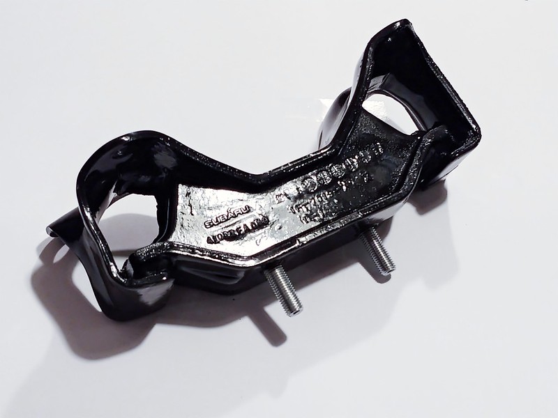

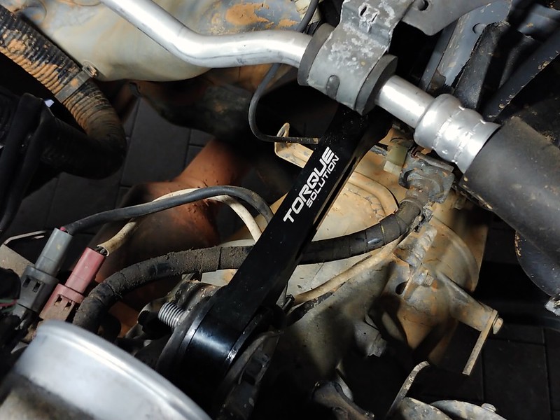

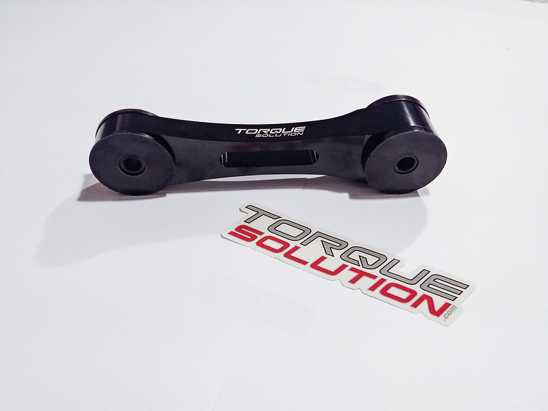

In the 1.5 year of ownership I started to develop a few clunking noises. One was that 2 wheels studs nad snapped off on my front right wheel and the other was due to a completely failed transmission mount. The bushings were shot and on one side I was able to completely move the rubber. When I would drive and take off from a spot, you could hear and feel the transmission moving back and forth which is a sketchy feeling. I initially just wanted to replace the part with an OEM part but then looked into the Group N STi mount which features urethane bushings. Its also really made for race cars for more feedback and response which in-turn produces for noise from the trans. I took a chance on it and I have no regrets. It does create more noise in the cabin but is super solid. I also went ahead and replaced the pitch stop mount located behind the upper air box thing near the firewall. When the old on came out there wasnt any sign or failure but I thought it would've been something to replace anyway. The pitch mount is made by Torque Solution and I have bought products in the past from them, like a short shifter and bushings for my old LGT.
