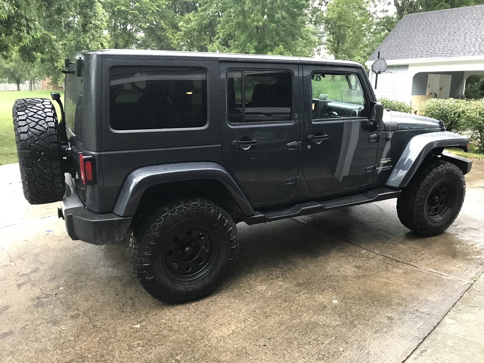

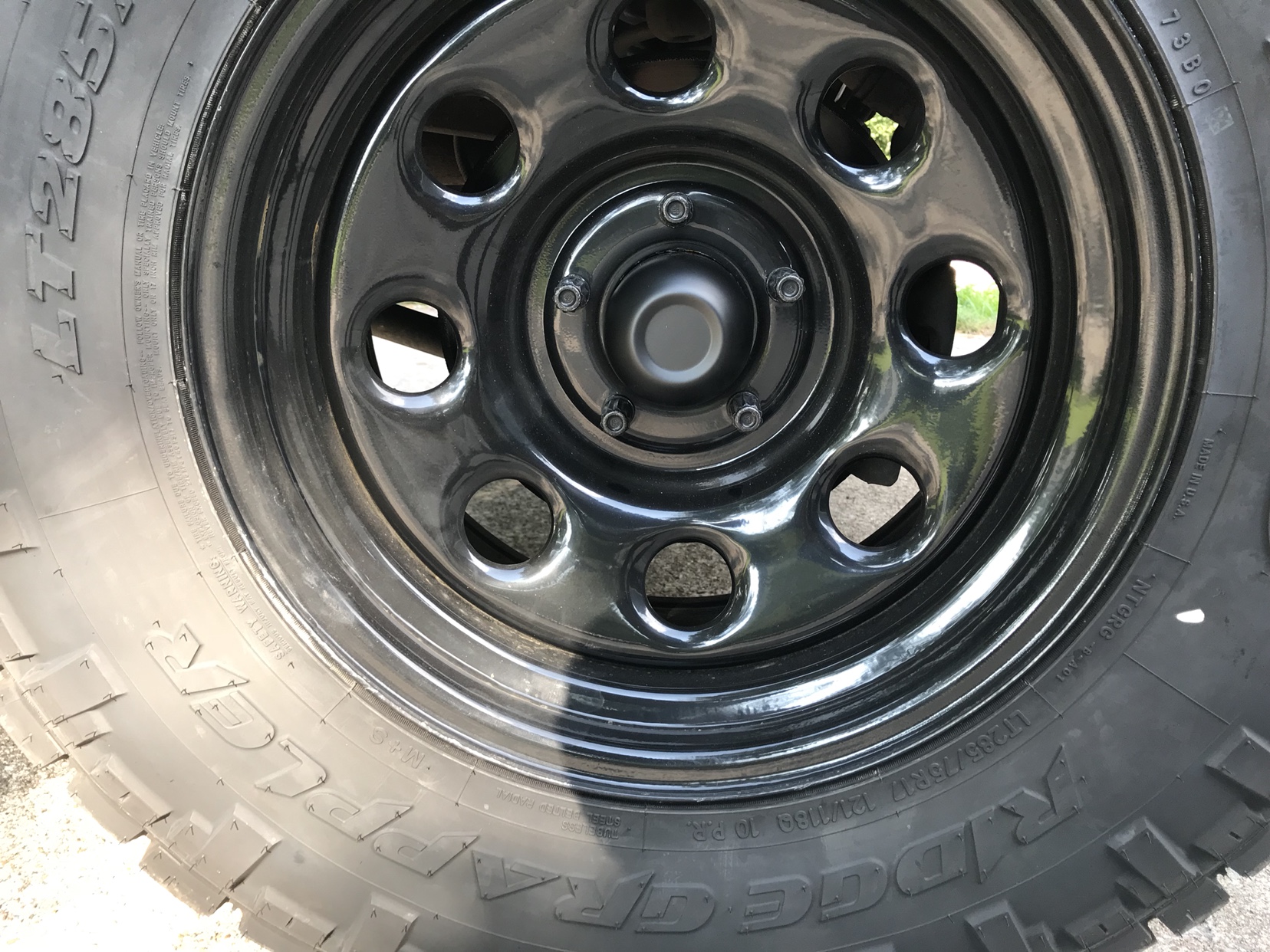

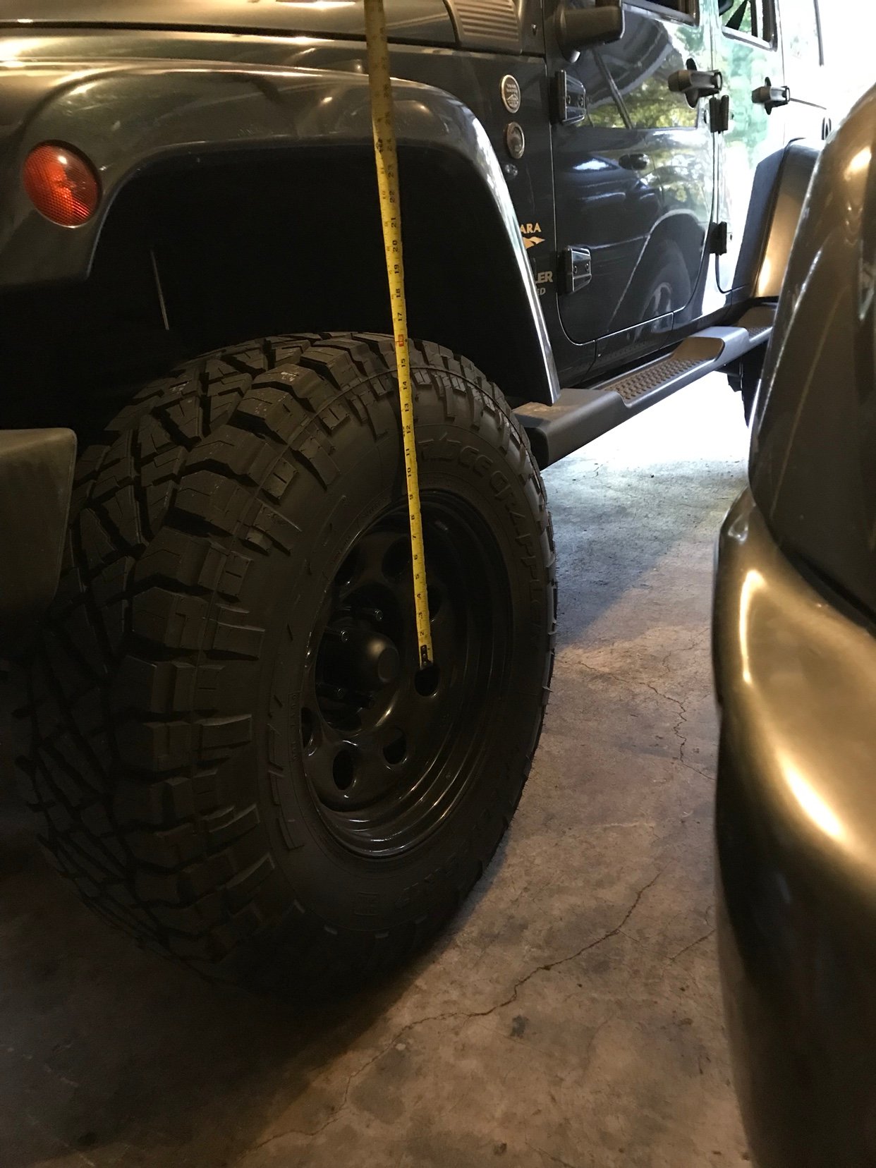

I just purchased this 2008 JKU. It’s my first Jeep. I want to build it up to be an Overland rig. How do I determine how much it’s lifted? Those are 35” tires on 20” Mall Crawler rims. I’ve already sold those tire/rim combos and replaced them with 17” basic steel rims and 33” NITTO Ridge Grapplers. Thanks!

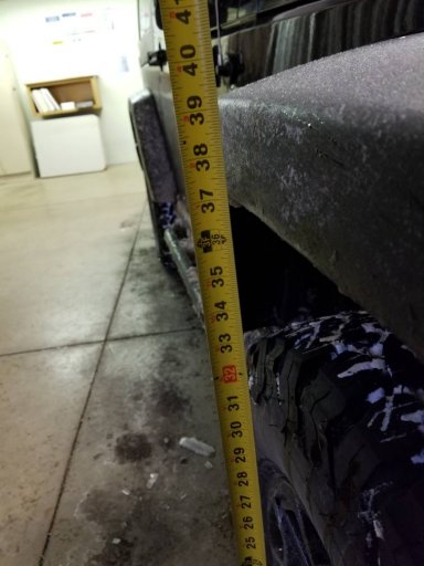

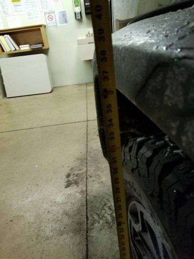

Just pull up to a dealership with a stock one in the lot and use a tape measure. Here are a couple pics of my 2door measurements when it was stock. 1st one is front 2nd is rear. I would guess the 2 and 4 door would be pretty similar height. Mine was a willys so it had 255 75 r17 tires20180101_161148.jpeg20180101_161139.jpeg

Talt2008 has a great idea. Just keep in mind that you will need to compensate for the difference in tire size also. My 35’s are about 3” taller than Talt2008’s 255/75/17s, but that’s not a 3” lift... just bigger tires.

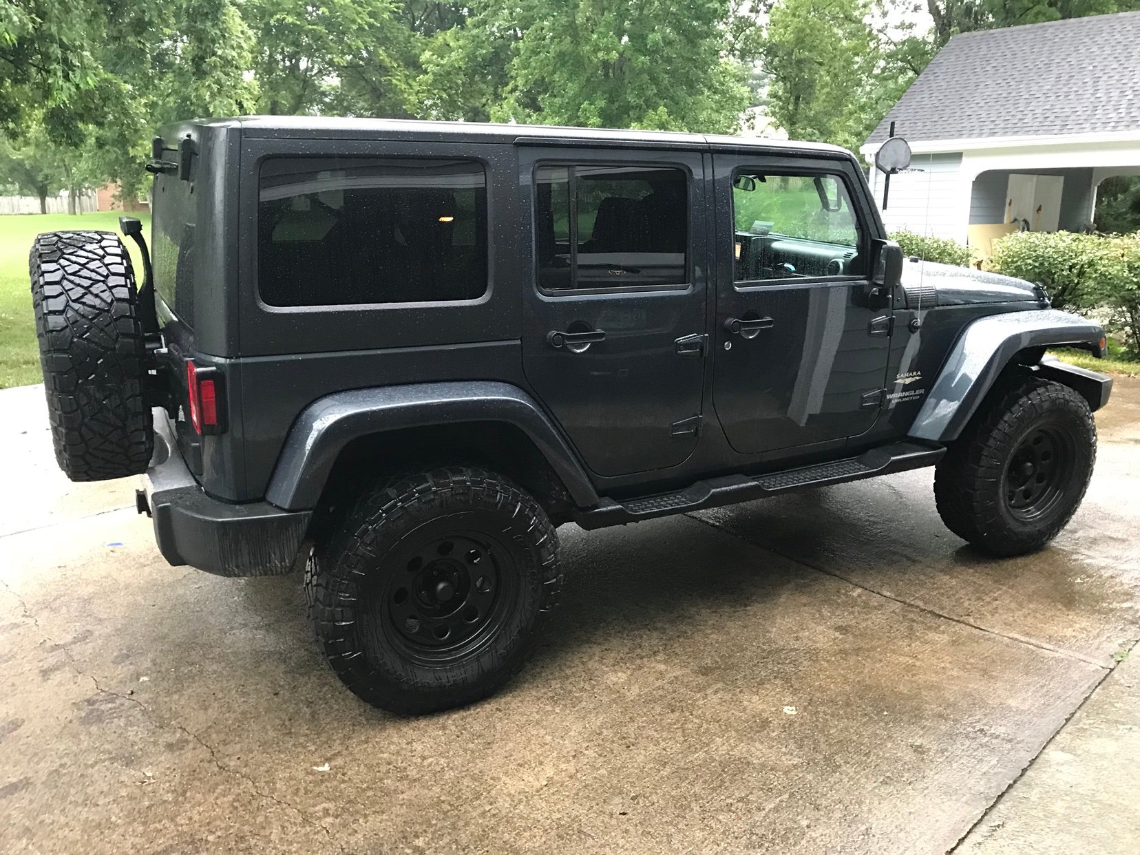

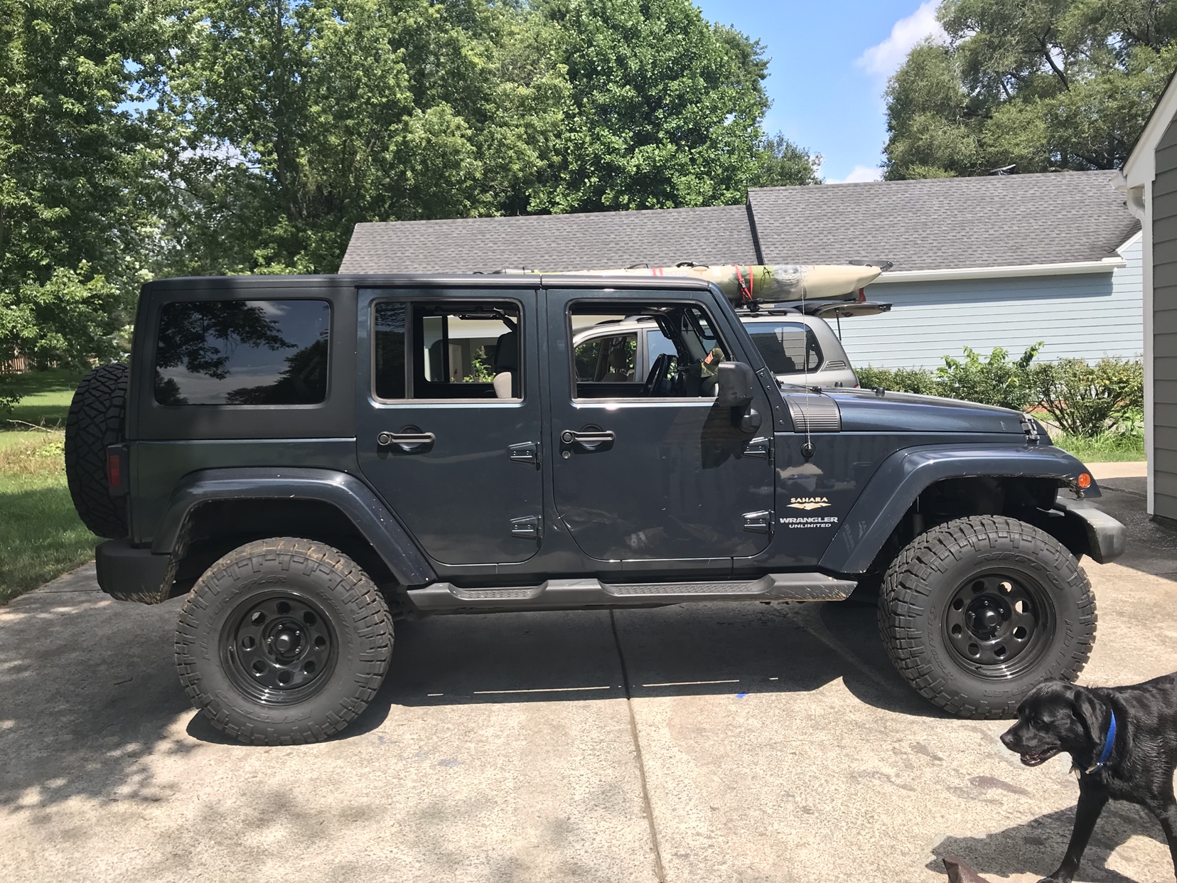

so I finally measured my Jeep. Center of hub to bottom of fender is about 24”. What does that tell me about the lift? Thanks!!
