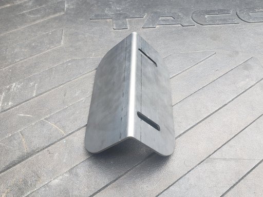

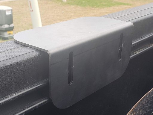

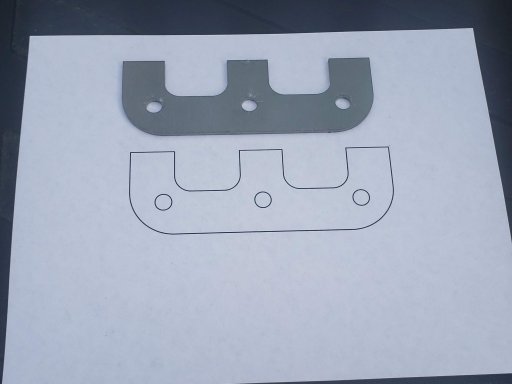

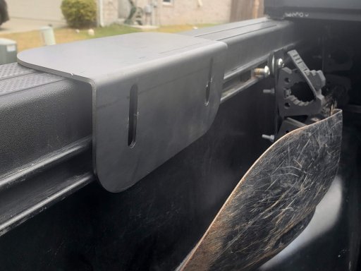

Got the bed brackets bent up today.... Discovered a few minor adjustments that will likely get done at final assembly.
I may need to extend the bolt slots a bit.
Top of the bracket is a hair longer than I would like, once the bed bars are welded on I may trim this a bit to keep it flush with the bed side.

Did you break all the pieces?
You don't need to extend or shorten anything, you need to relocate the break to move the slot down and the outer tab in.
I don't know what you paid for those, but I'd start over and save those for another project.

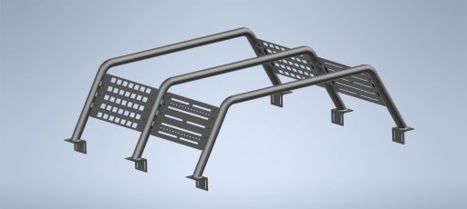

Woot! Progress lol, those look fantastic, even better than your cad drawing

Nice job!
Do you mind saying who you are using for the laser table work?

Why not use square or rectangle tube? Some 1X3 16 ga tube would look good and be fairly light weight. And much easier to attach stuff to than round tube.
Todd
I thought about it, but I like the sleek look of the round tube. even though I could do a square tube rack easier than the round
