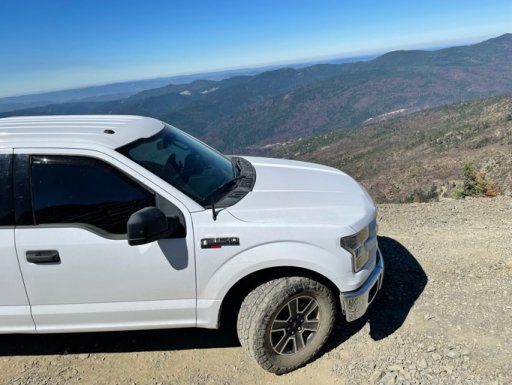

This truck has proven to be very very capable in its stock form, so not much was needed in terms of modifications. It came out of the factory 4x4, with locking rear differential, plenty of undercarriage clearance, 400 hp, 400 lb-ft of torque. After many years of lifting other trucks, stuffing tires, trimming wheel wells, rubbing, recalibrating speedos, and all the things that come with lifts, I didn't want or need to jack this thing up. I chose to go with a simple 2" leveling kit by Rough Country. I did the lift myself in my shop in Berkeley CA.
lift day:
how she looked on stock wheels/tires with a two inch lift.
I marked and measured the apex of the wheel wells before the lift and was at 37 1/8". After the lift, I netted 2", jumping to 39 1/4".
After the lift, I slapped on a set of Goodyear Duratracs 275/70 R18 on the stock Sport Package wheels which I really love. The tire measures out in inches to 33.3" x 10.8". I have always run 33 x 12.50" tires on my old truck and on our Jeep JK, but since this thing for the majority of its life will be used to haul my family around, I wanted to keep the cabin noise down so I went with a tire that would fit just inside the wheel wells. I also wanted to minimize the MPG loss and power loss. So far, I am loving it. I measured the cabin at freeway speed with a meter at an avg of 65 dB, post 33's, the avg only increased to 66 dB. The crossbars actually gave a bigger increase in cabin noise jumping almost 3 dB when I put them on. I was tempted to stuff 35's under there, but on top of all of the reasons I listed above, I believe 33" is the perfect off road tires size. It gets you the clearance you need, but is still easy to source in case you are in a pinch for a replacement some place in the middle of nowhere.

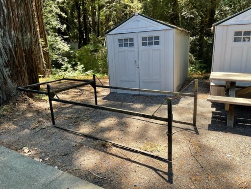

Coming along great. How are you going to secure you rack to your bed?
