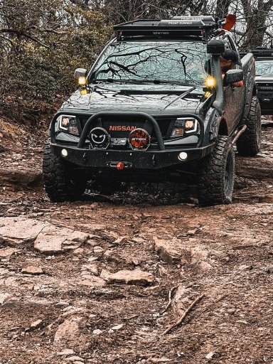

Here is my build thread for my 2013 Nissan Frontier. It started off as a basic SV 4x4. I completed a titan swap with all CJD control arms and steering with some Radflo 2.5 coilovers, and rear shocks. The rear has a set of custom Alcan leaf packs rated for 550 lbs over stock and 3" of lift. It also has a set of Z1 offroad shackles. It is now fitted with a set of Fox 2.5 Elite Performance shocks at all 4 corners.
For armor, I'm running a Shrockworks front bumper and Skids. White Knuckle Sliders and a Coastal Offroad rear with swing arm.
The driveline modifications include a M205 (Titan front diff), and a M226 rear out of a Frontier. It retains the factory rear elocker. I've installed some 4.08 gears from All Dogs Offroad. I do have a Tre4x4 front locker that still needs to be installed.
The brakes are a complete Z1 Offroad big brake kit. And for wheels and tires are Z1 Offroad ATK-04 17x8.5 wheels wrapped in Ironman All Country M/T's in 315/70R17s.
For the engine, I have a set of high energy Z1 Coil Packs, Z1 hose kit, Z1 cold air intake to a Z1 snorkel kit topped with a Snorkel Upgrade pre-filter. I also have a Z1 catch can and heater hose upgrade. A CSF Radiator has been installed. Last is a Titan 200 amp alternator with a Preformance alternator upgrade kit.
Lighting includes headlight assemblies from Akkon, tail lights from EnzoUSA, bumper lights from Stedi. My ditch lights are currently Stedi as well with my roof bar from KC along with a set of chase lights from KC.
My current camp setup includes a medium CVT Mt. Hood RTT. Kickass control hub, Kickass fridge, Kickass solar panel, Renogy AGM secondary battery. My current awning is from Front Runner and a Kickass shower awning.
Communications is provided by Midland with their GMRS radio, small antenna mounted on the roof. And a heavy duty bull bar antenna as well.
For the interior, I kept it simple. I completed a Pathfinder center console swap. Added a ICS dash kit for mounting accessories. A Stinger head unit, Wolfbox rear view mirror and a throttle controller from iDrive. Weather tech floor mats help control the mess.
The rest of my exterior accessories include Front Runner Roof racks. A Century truck shell, Smittybilt 9.5k winch and Hi-Lift Jack.
It is about to go thru a small transformation with a flatbed conversion, custom built canopy setup. I'll also be swapping to a CVT 270 awning.
