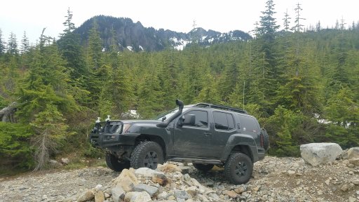

Hello everyone!
Member number #1361 here. Finally becoming more active on this forum. I have a 2010 Nissan Xterra 4x4 that I purchased in 2012 with 35k miles while I was living in Colorado. Since then I have moved to the PNW and currently living in Kirkland, WA. I started my build two years ago and just "completed" it a month or so ago. I am an active user on thenewX.org and will copy my build info directly from that site
Make: Nissan
Year: 2010
Model: Xterra
Trim: X 4x4
Color: Knight Armor
November 2017 - TNX Truck of the Month
August 2018 - TNX Truck of the Month
Mileage: 116k
Rear m226 Axle: 110k
Front r180 diff: 40k
MODS
Tires/Wheels:
Goodyear Duratrac 285/75/16
1" Spacers
2012 Pro4x Rims powder coated black
Suspension:
-Front-
Radflo 2.0 Coilovers @650
.5" Coilover Spacers
SPC greaseable UCA
SPC Cam Bolt Kit
Coilover Bucket cut back
-Rear-
2011 Pro4x Leaf Springs
Nisstec Adjustable Shackles @ #3
PRG 2.5" Dual AAL
Radflo 2.0 Rear Emulsion Shocks
Exterior:
HiLift Mounts onto ARB
Engo XR 10k with Synthetic Rope
P&P front Recovery Points w/ 3/4" shackles
Tinted Windows
Gobi Ladder
Tepui Kukenam Siberian Camo Roof Top Tent
Volant CAI + Airflow Snorkel = Airtight sealed
FlowMaster 40 Muffler
Towing Mirrors
Shrockworks Rear Bumper w/ Tire Carrier
Front Runner Outfitters Drop Down Table mounted to the Shrock
Gobi Stealth Rack
Armor:
ARB Front Bumper
White Knuckle Sliders
Rear Taillight Guards
ARB diff cover
Pro4X stock skids
Interior:
Custom Storage Rack in Trunk
Custom "LoMo" Rack
99% of the time back seats are down and I'm in "Truck Mode"
CoverKing Tactical Seat Covers with MOLLE
Xterra rocker light switches
Winch control switch mounted in light switch panel
Uniden Pro520XL CB mounted to dash
ARB Essentials Recovery Kit
ARB Single air compressor w/ case
Lighting:
X6 10W Series 2D Amber & White Single Row LED Light Bar
2 PIAA 5" LED Driving Lights
2 Eyourlife LED lights mounted on the hood
Rear Bumper LED's mounted onto plastic sides
LED Headlights
Maintenance:
Full Synthetic Oil every 5k
Front and rear diff just changed @95,000
Transfer case oil changed @87,000
Transmission flush @95,000
New Brake pads and rotors @95,000
New Spark Plugs a@99,365
Serpentine Belt & Belt Tensioner @111k
New front passenger CV axle @116k
New rear passenger brake caliper @116k
Tie Rod Ends @117K
Earlier this summer I swapped the rear axle and the front diff to a 3.69 gear ratio and wired up an elocker in the rear.
Its my daily driver and I try to make it to the mountains every weekend to explore some new area around Washington. DSC00898.jpg 20181104_112221.jpg 20181007_141905.jpg 20180831_185605.jpg 20180828_183224.jpg paWENmG.jpg 20180827_153732.jpg 20180728_143710.jpg 20180721_110803.jpg 20180715_111935.jpg 20180613_114518.jpg 20180612_134331.jpg 20180505_194802.jpg 20180429_130628.jpg 20180429_102154.jpg
