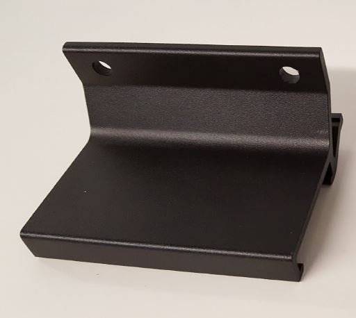

Or.....Can anyone send the measurements of their Yakima Awning Mounts?

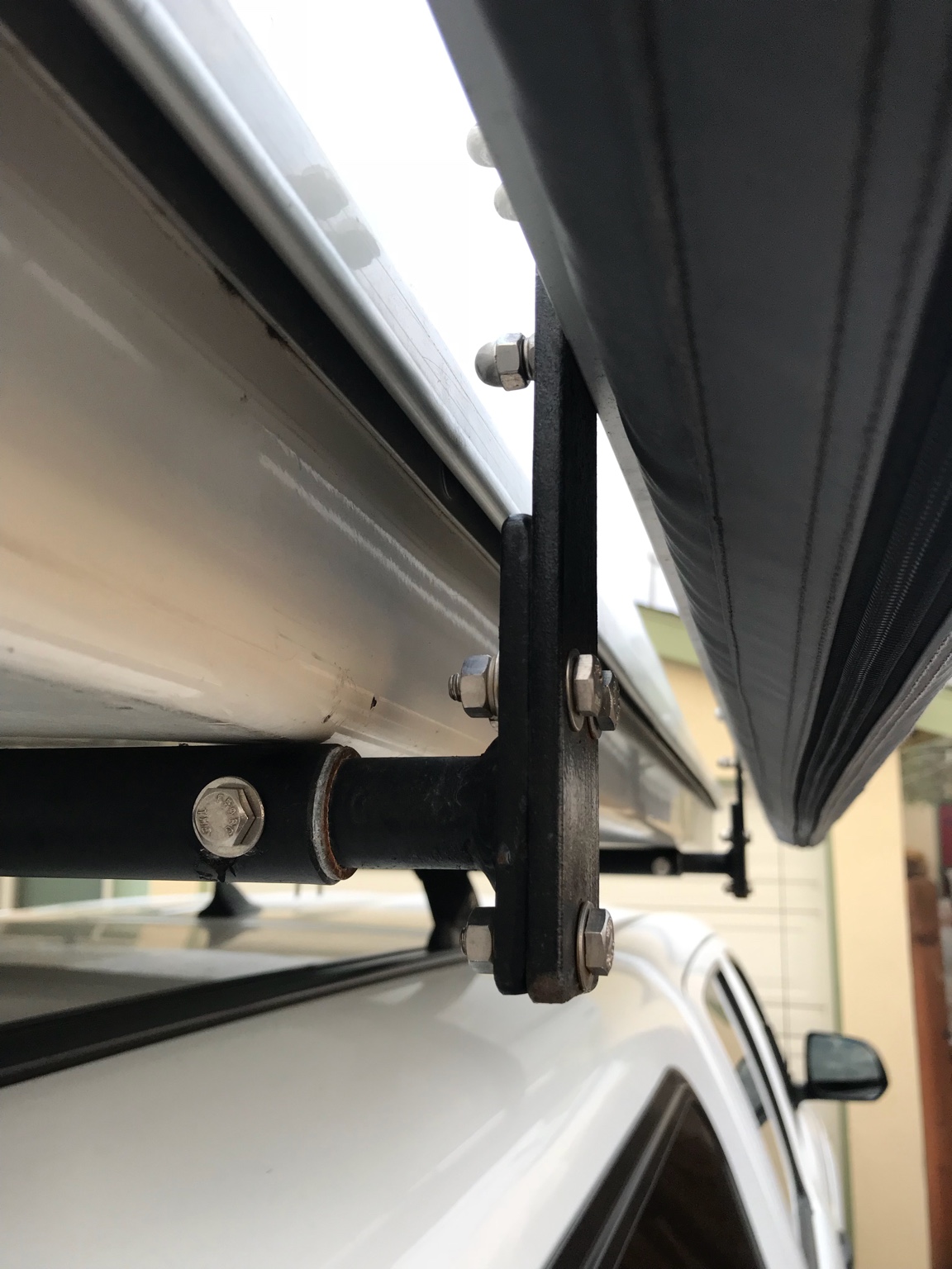

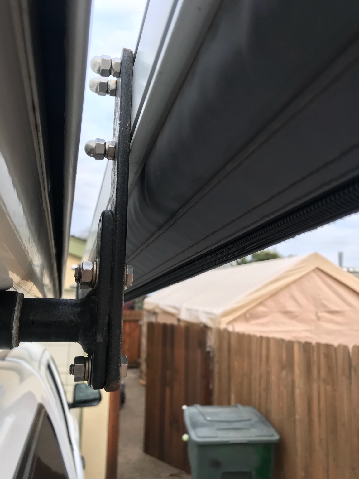

I had the same need for my racks, but since they all were priced over $5 I decided they weren’t worth it and I zapped these together from some scrap steel. It ended up costing a few bucks for the stainless hardware, but they’re very solid and easily modified. The awning ended up a little low when I first mounted it so I added the extension so I wouldn’t hit my head( I’m 6’4”) anymore.
