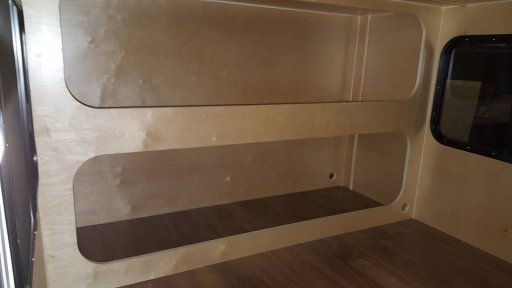

Look at a Hiker, they have a third child bunk option.
