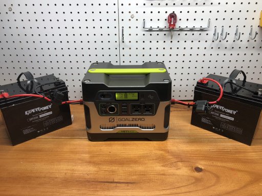

I bought my GoalZero Yeti400 to run my A-PAP and charge stuff up while camping. Then I ditched my cooler and got a fridge. The Yeti can run the fridge all night but a fridge and the A-PAP puts a big drain on it. There are Anderson ports on each side so you can daisy chain 400s together, so why not just use a regular 33ah battery similar to what sits inside the sexy Yeti case? After some googling I found quit a few people have done this with great results.
I purchased everything from Amazon, I’ll link below, except the Yeti400. I got that from GoalZero’s website under blemished items. Hardly a tiny scratch on it but knocked $100 off the price. You can find some of this stuff cheaper at other sites if you’re willing to wait on shipping.

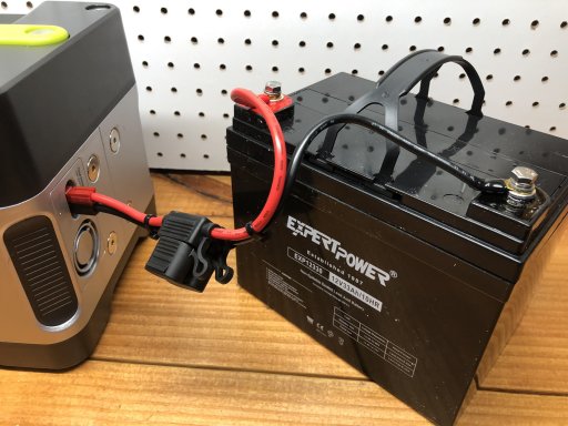

Got my Yeti400, 33ah batteries and my Anderson-to-post connectors all set up now. Everything charges/discharges through the Yeti as if it’s one big battery. I can run it with both batteries connected (1200wh), one battery connected (800wh) or just the Yeti (400wh). NOTE: doing this does not increase power output, that’s governed by the Yeti’s inverter, it only adds power reserve to run stuff longer. Still can’t plug a 1100w AC into it and expect it to work. 300w per plug is the max on the yeti400.

And here are the pics of the setup on my bench. I’ll post more pics once everything is in the Jeep.
I will post updates as to how it’s all working as I go.

It’s not a lot of AH, but for the price and size it’s pretty good. I’ve already run the fridge a full 26hrs off the Yeti alone, by tripling the storage capacity I should be good for a long weekend. I’ve got a small solar panel that will help when parked, and the Yeti will be plugged into the Jeep when driving so everything will charge up as we wheel around. I don’t plan on letting my Jeep sit in one spot for more than a couple days, but if I do, I can always charge everything back up by running my giant generator of a Jeep. Pretty sure I’ll be ok.

No worries, it seems this set up works for you. I have a lot of power needs. I have four 6V golf cart batteries hooked in series and parallel to give me 12V and a total of 480Ah. I am running up tp 4 led spots, the Dometic CFX 75, and an ICOM 7300 HF ham radio. I hook the bats up to a briefcase 200w solar panel that I can put 100 feet from the Scout trailer. Just in case, I also bring the Honda i2000 with plenty of Rec gas.

Curious on how you are storing the two extra batteries in your truck with the Goal Zero?
