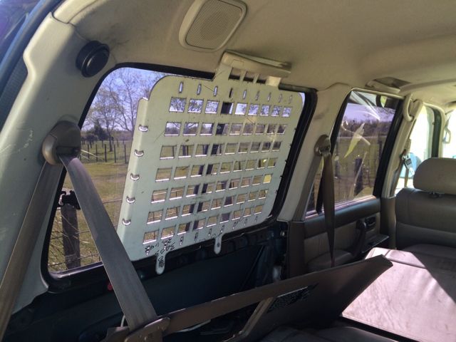

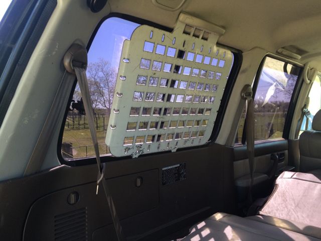

Anyways, I searched to see what kind of different storage solutions there are and didn't quite find what I was looking for. Of course I need the drawer system one of these days and tailgate storage eventually, but I wanted something simple that goes over the rear side windows (gull windows). The lift up gull windows are awesome but not in the budget and I don't know if I would like not having a window there.
I'm not taking credit for this as there maybe a something like this already that I couldn't find. This is just an idea.

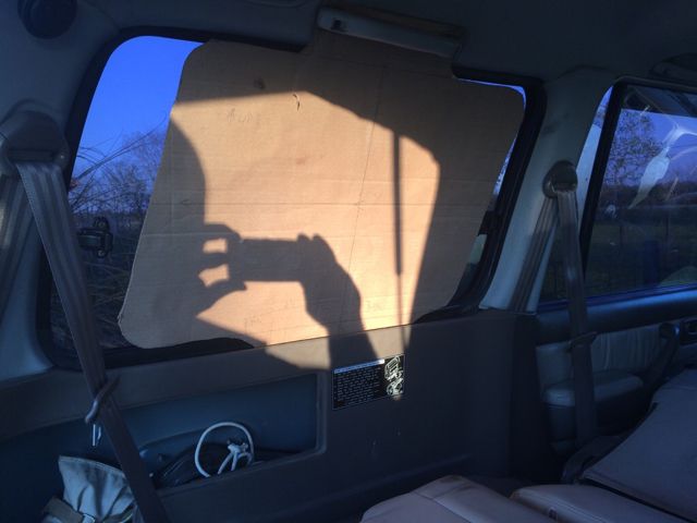

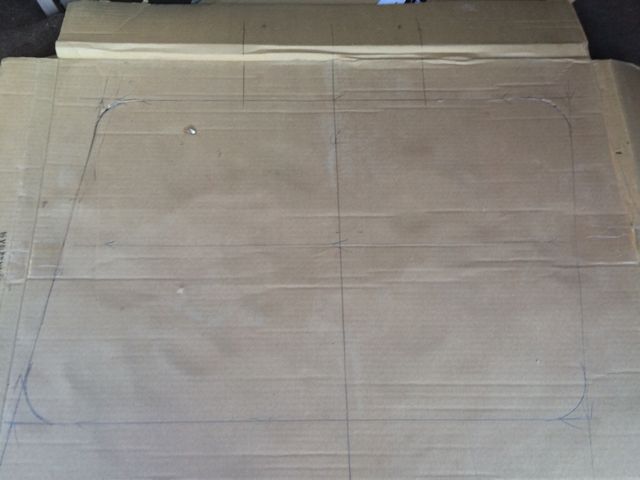

The cardboard design.
The install of the cardboard to see if I like it.

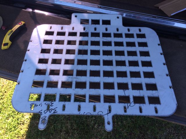

Went to work and drew it out on AutoCad and printed on large paper and brought home and decided I need to tweak it some more. Sorry no photos of the paper install. I decide that I didn't want to follow the window lines and just made it straight on the sides with a 90 degree bend for rigidity.

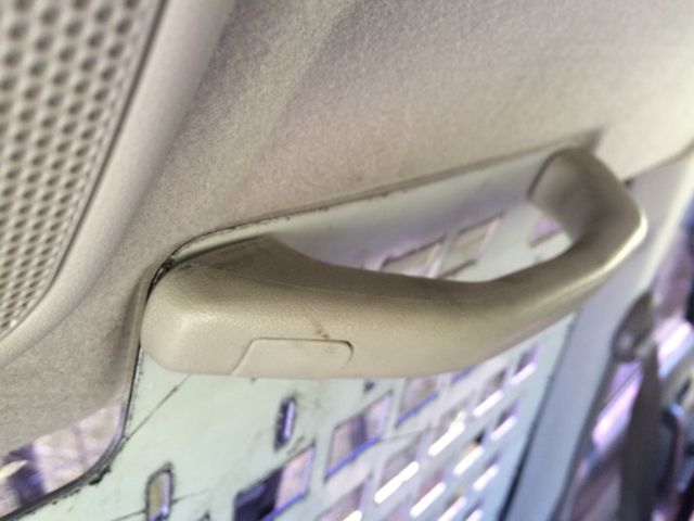

Pulled the side plastics off and the grab handle off and reinstalled the grab handle with rack mounted underneath.

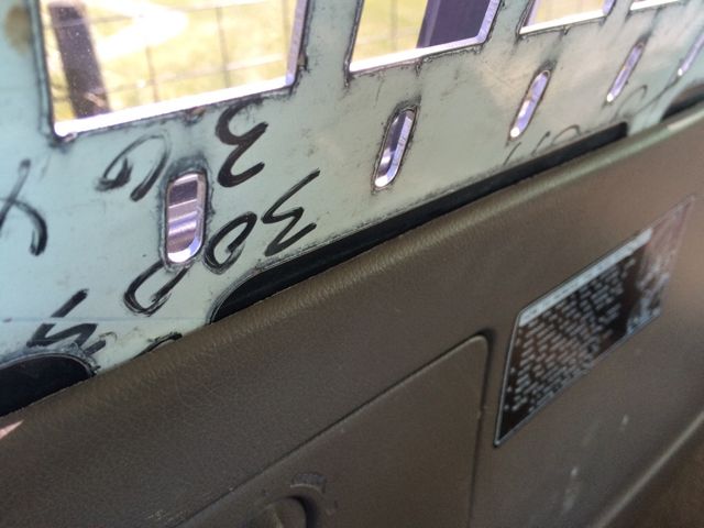

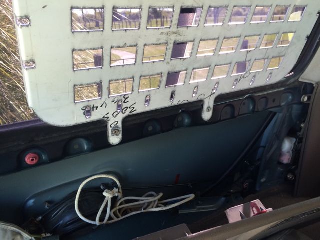

Next I had to drill 2 holes and use some self tapping screws for the bottom and then reinstall the plastics.
Everything fits good, now I need to send off for powered coating and reinstall.
Here are a couple of more photos...
Behind the plastics
Behind the grab handle

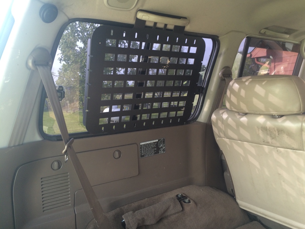

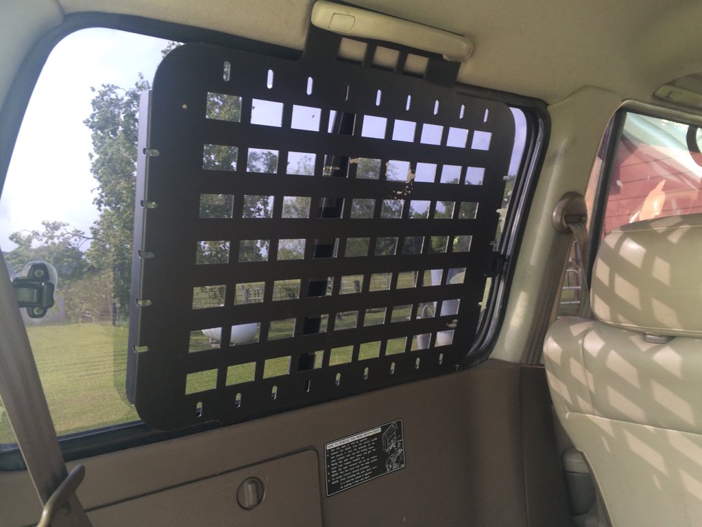

Sorry for not updating, but here are a few pictures of the finished panel. I ended up just sanding down and then used plastic dip for the coating.
As for selling them...It didn't really think there would be any interest, but its definitely doable. Let me work up a price and post it up in a couple of days.
