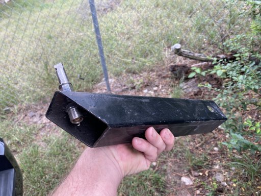

For HF mobile,I’ve used a Hustler whip setup with resonators for each band 10-80. I have the spring and quick disconnect as well. The mount currently use plugs into the hitch receiver. You can see a couple of the resonators just in front of the drawers.
