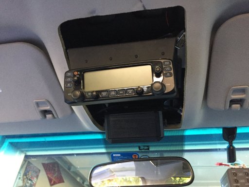

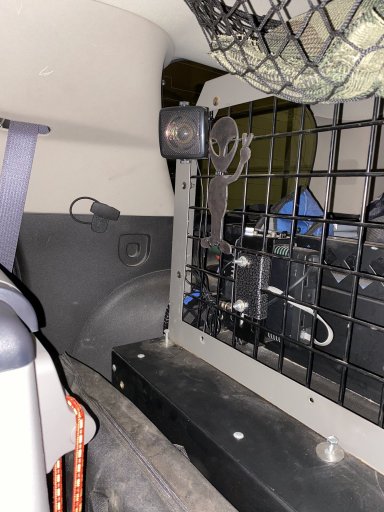

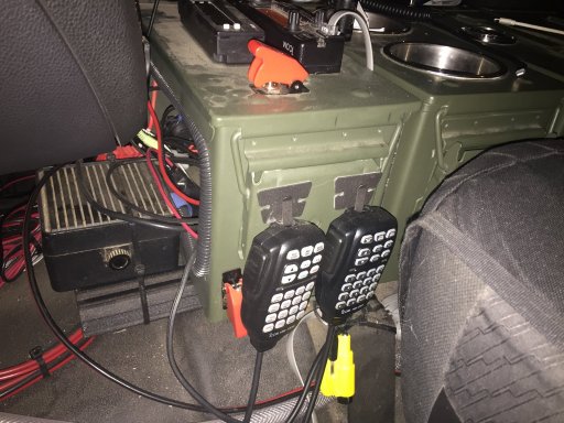

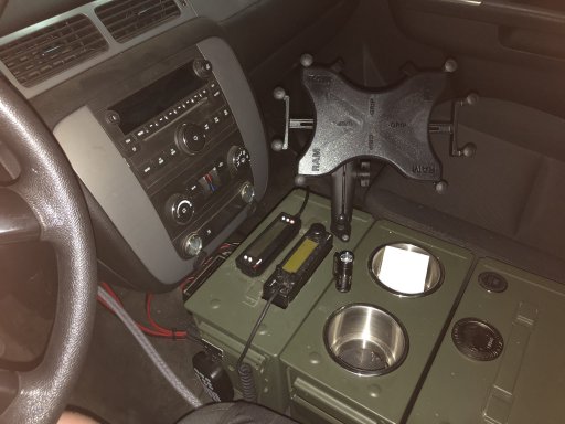

@Ubiety you mentioned faceplates and extension cables. I used them quite liberally in thecopcar. The display for the 2730 is overhead, the mic below, and radio with speaker behind.
the speaker behind the display is for my IC2200. The speaker near the mics is for an hf rig if I’m carrying one.
ET stands guard.
BTW, the bracket the 2730 is in is for a Kenwood TM2530.

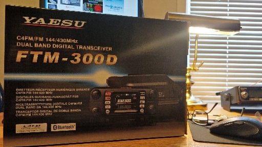

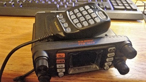

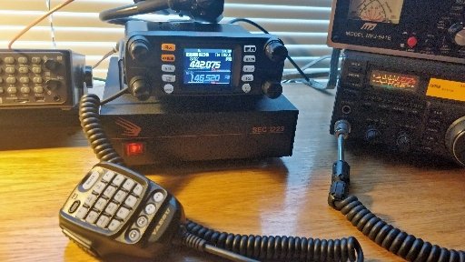

I agree that the Yaesu FTM-400 is a great radio, but I just purchased the FTM-300D about a week ago from HRO- Oakland for $419. That is about 100 off the FTM-400 price. What helped in my decision was that I'm using it for a base unit. The FTM-400 does not attach to the main base unit....must be separated for installation. Check out youtube for comparison of the two radios. I'm just south of you in San Lorenzo if you need help with the install. I run the FTM-100D in my truck and love it!
