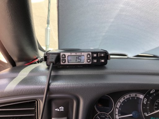

Got my GMRS acceptance from the FCC today as well as my Midland MXT105. Seems to work as advertised. I was able to make test calls from this device to my Uniden GMRS handheld radio.
Question - can these base GMRS radio be calibrated like CBs with a SWR meter? I have a SWR meter but not sure if it makes any sense to calibrate this unit / antenna. IMG_2919.JPGIMG_2920.JPGIMG_0033.JPG

Lookin good.
Can you check SWR? Sure, but you will want an SWR meter that works for UHF frequencies.
The antenna that comes with that radio likely isn't tuneable and really you probably don't even need to worry about it.
It's nice to check but even on my 2m ham radios I have never had to worry about tuning the antenna out of the box.

Thanks for confirming my thoughts on it. I used a different/taller antenna than the one that came with it, but neither are tunable unlike the FireStik antenna that I have for my CB.

The Midland's are nice rigs. Most of the commercial grade antennas I've bought/installed came with a cutting chart. I've been careful to measure and cut to proper length and have had good results. I think the antennas available from Midland would do well and likely not need trimming/tuning.

I have the MXT275 and the matching midland 6db antenna for it. A buddy has the proper swr meter and the thing was spot on out of the box.

Yeah I wanted to put this longer antenna anyhow so that it would be taller than the equipment already on my cab and camper shell. IMG_2915.JPG
The antenna that comes with the kit is less than half this height.
