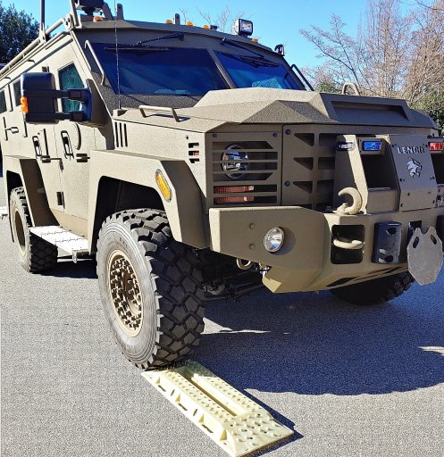

Good Day Guys!
I'm still new to the overland community but I use 100% American made and manufactured a new product call the VRE-TRAK it's a traction board that outperforms everything on the market today. Holding weight limit of 35,500 lbs+ .

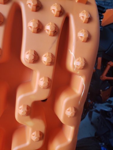

Well, I used them up in Mammoth. My AEV weighs in at just under 9K lbs. Got stuck in a few feet of snow. You can see the crack in one. I wouldn't trust these anymore at least for my rig. Going to upgrade. 20200114_140809.jpg

Good Day Guys!
I'm still new to the overland community but we are a manufacture of police and military equipment 100% American made and manufactured. We just launched a new product call the VRE-TRAK it's a traction board that outperforms everything on the market today. We have a holding weight limit of 35,500 lbs+ Were searching for a bigger vehicles. I have discount codes and i will throw in a free bag for the community if anyone's interested.
See my above post. LMK if you'd like me to try them and review. I can go out to Azusa canyon which is a nice mud hole and do a review.

Wow!! What brand are those? Not good!

Yes our main product with @MilspecPlastics is military approved flexcuffs and other products. There is a huge list that sets us apart from the others.. the top 3 reasons..
1) 100% made and manufactured in the USA
2) 35,000 lbs+ capacity (still testing/ looking for bigger vehicles)
3) The best customer service!
