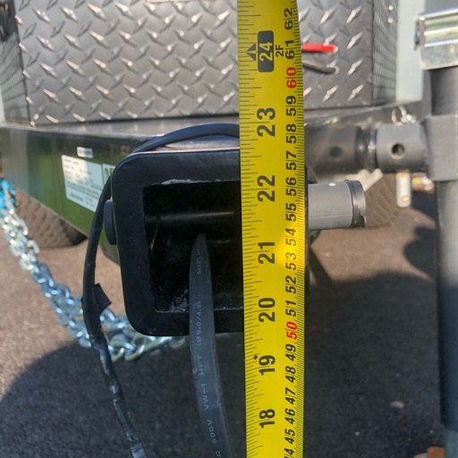

Wondering if any current Manley owners could tell me what the coupler height is on their trailer? I'm trying to determine how much rise I'll need on my ball.

If your looking to make it level Your gonna have to back whatever you have up to one and measure it. A coupler can be all the way on the ground, up so high the rear of the trailer is on the ground or anywhere in between.
Their website for the basic one says it has 31" tire and what looks like a 3" frame and id add another 3-4" between the axle and frame for leaf springs so id reckon somewhere between 19 and 22" from the coupler to the ground.

I'm 10" from the ground to the top of the receiver hole. Unless somebody has a Manley trailer and can give me the second half of the equation, I'll probably just wait and have my friend tow the trailer back to our place from the dock, and get my own measurement at that point.
