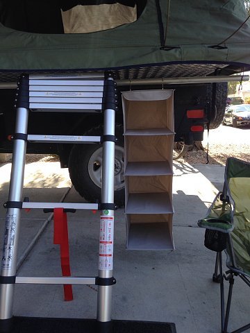

It's nice to have a convenient place to store items you want easy access to getting into or out of the tent (flip flop, toiletries, etc.) so I picked up a couple of "closet organizers" that were perfect for the job. I suspended an aluminum flag pole I had sitting in the garage under the tent with a couple of wire ties and hung the organizers where they were easy to get to.
View attachment 29788 View attachment 29789
Ohhhh...that is a GOOD idea! I like that! Thanks!

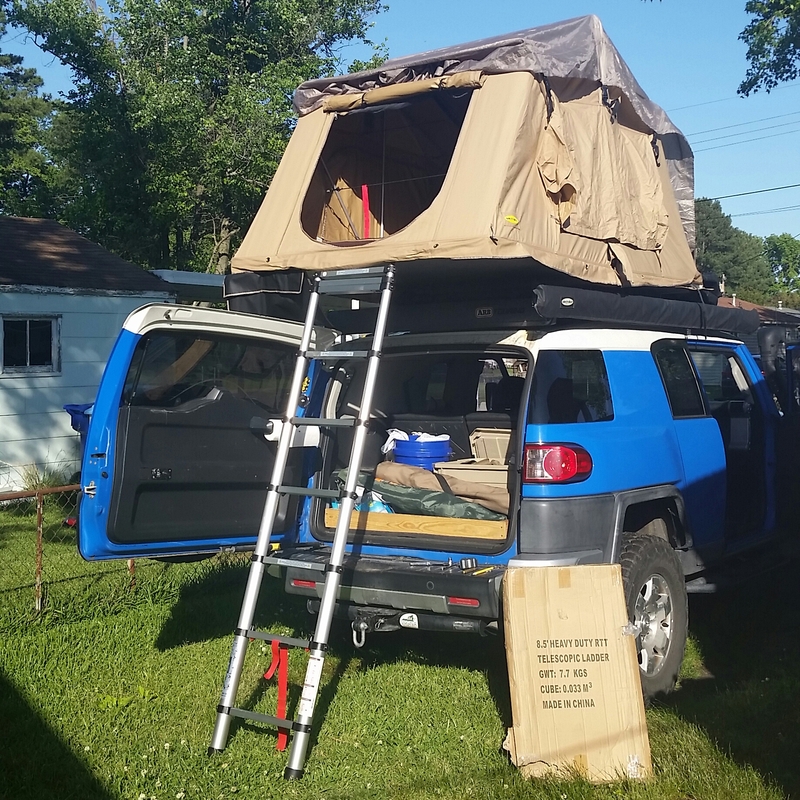

When we got our RTT, I asked my wife how she wanted it to open. She liked the idea of opening toward the back. This is not always the most convenient setup for accessing the rear cargo area with the tent deployed, but it keeps our setup narrow and has allowed us to fit in places we couldn't have otherwise and has made getting level trivially easy. Since we're still running the OEM roof rack, it also distributes the load of an occupied tent better. If I ever come up with $1,200 to blow on a flat rack, I may revisit the rear opening, but for the time being, this is it.

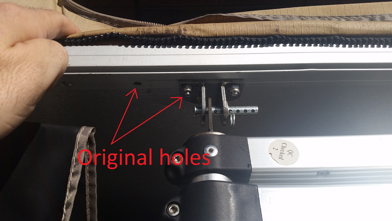

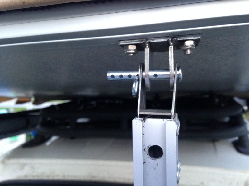

The first mod we did was to make the ladder easily removable when the tent is unoccupied. We used some cheap 5/16" clevis pins.
As we used things more and more, we found that, while the ladder was the perfect length for flat ground, on uneven terrain we sometimes exceeding the maximum possible height for the stock extension ladder. It was easily corrected with rocks or a couple pieces of wood, but a friend wound up with a spare telescoping ladder from Tepui and offered it to us. It was a simple matter of drilling one new hole, and the original ladder can be reinstalled at any time.
My only other tip you can sort of see in the above photo. Whenever we close up the tent, I always run the rear-most bungee cord through the handle loops for the access strap. That ensures that when you open the tent, the straps are at the ladder and easily accessible.
