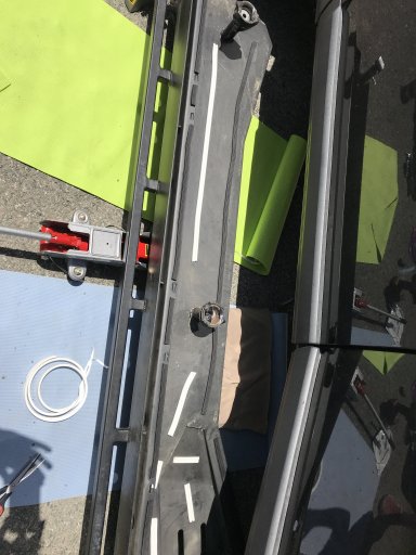

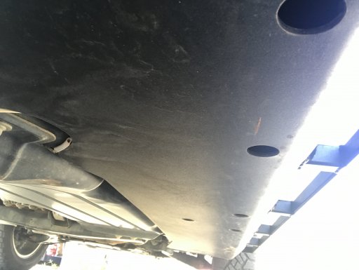

I ended up going with Tactical Rover 4x4 rock sliders because they covered my air compressor and it's original housing without any modifications. I have taken the sliders off and put them on with ease. I place an 8" piece of 2x4 wood on a jack and then slowly raise the sliders up, I had my 7 yr old son operate the jack while I balanced the sliders. Make sure the sliders are firmly pressed against the sill/vehicle as to avoid any space/gaps between sliders and vehicle to ensure bolts are as tight as possible (I raised sliders/jack to point of almost lifting vehicle). Before inserting bolts, align all holes on slider with vehicle...I learned this the hard way. Have a longer screwdriver on hand for aligning the longer bolts. Removing is similar process...raise jack with wood, then undo all bolts, then I had son slowly lower jack while I balanced the slidersIMG_2177.JPG IMG_2179.JPG IMG_2180.JPG IMG_2182.JPG IMG_2183.JPG IMG_2185.JPG IMG_2181.JPG

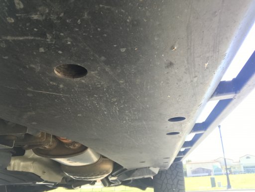

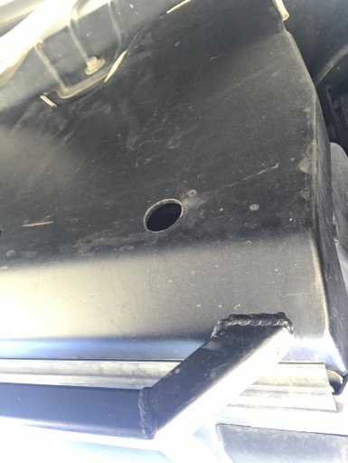

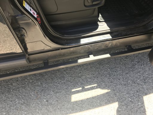

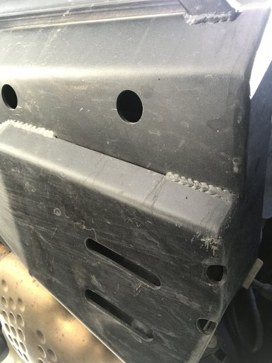

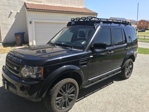

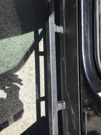

IMG_1772.JPG Yes, removed the plastic sill/rocker guards...I attached a link to the install directions from tactical rover, which provide better detail and are easy to follow. There is a small gap between the frame and the sliders. I've read about the concerns regarding water crossings...all water crossings I've completed with LR4 since install haven't reached up to my door, so I can't say what will happen in deep water. The way the sliders are built, the water should just pour out from the holes underneath the sliders (reference previous post pics). The portion of slider connecting sliders to frame is elevated over the base of sliders, so water and dirt don't get into bolt/nut/housing...hard to explain. I don't believe it will be an issue, but I will be looking for some water in the next few weeks and will update then. The first two pics are passenger side and the next two are driver's side. Lastly, Eric, the owner of tactical rover, and the Lucky 8 guys have been extremely helpful answering all my questions. One last thing, I purchased weather stripping from Home Depot and placed it on my sliders due to reading some people experience creaking noises when sliders rub against frame. I heard the same after about a month without stripping...since installing whether sliders touch frame, no issues (see attached photo)
Side note, I'm running the Proud Rhino SYA off road extension kit, which I installed the 2" spacers on top of my struts, with limiting straps and the proud rhino lift rods, so the Landy is 2.5" taller, which raises off road height as well...and I've absolutely loved it. Hardly had to use off road height in Moab last week, at least compared to usualIMG_2198.JPG IMG_2197.JPG IMG_2196.JPG IMG_2195.JPG . I have the extension kit to ensure I can always drive off the trails in case of catastrophic air fault, as well as to accommodate the bigger tires I've recently purchased...18" wheels will be here next week from Lucky8.
