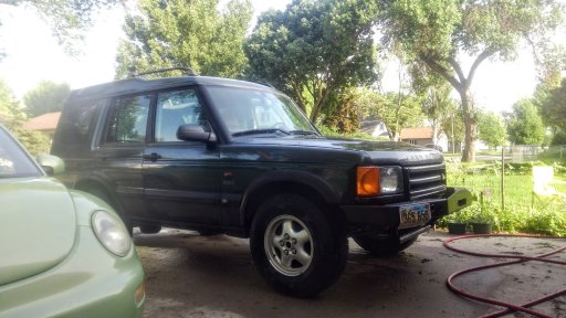

So, after a tough winter, I cruising the local buy/sell pages. Absent mindedly looking for a Toyota 4Runner or Jeep ( I had included Land Rover as a pipe dream) and this pops up.
"2000 Land Rover Discovery 2 , blown head gasket, no time to fix"
I pass, a week or more later it is still there, I start doing quick math. Purchase + parts + wrench time= 1/2 of retail, not bad. I pass, float the idea to wifey, no go.
Call seller , no/little rust , cattle farm , it had been run all winter checking fence lines, Ok. Call wifey from work, going to pick it up that Friday, lol, crickets.
That was a month ago, fast forward to today, all torn down , waiting on parts that will be here tomorrow.
This will not be a super build, but a budget build. A winter travel / exploring vehicle. The last couple years we have been " camping" out of 1 of 2 early century VW bugs, so let the adventure begin, lol, hope you enjoy the ride .KIMG2835.JPGKIMG2838.JPGKIMG2840.JPG

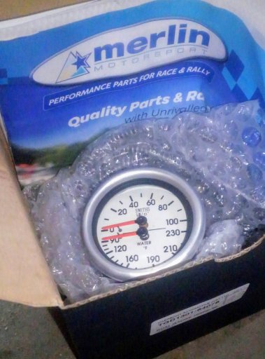

While waiting for the BBT to appear, what does the post man bring me from England?
My water temp / pressure gauge, figured it would be another week.
Now how to mount sending unit?
Noticed that my radiator hose T does not have a bleed screw , I opted to put one in along with the sensor.
It may turn out to need a support bracket do to increased weight, we will cross that bridge when we get there.
