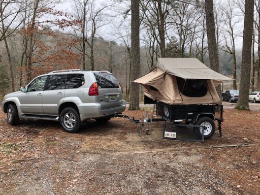

I welded 2 bars to the top to mount my RTT and it added a good deal of extra rigidity. Will eventually diamond plate it. Taken it on a few trails in the Talladega NF and the Bankhead NF. Just take my time and it does OK. It ain't a Turtleback, but that's OK, too. Loaded with my Solo firepit, chairs, 2 action packers, firewood, and an easy-up style popup canopy, it weighs about 500 lbs total. Axle upgrade later this year.

No problems yet, knock on wood. After the axle swap and bigger tires/wheels it has plenty of clearance. I’ve taken it on a few rough trails but was somewhat cautious. I’m sure a heavy diet of rough trails might not be wise but I wouldn’t hesitate to hit the road for Alaska right now.

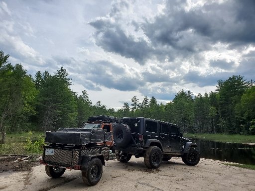

Oh man! What can I say about this. I have trailed literally everywhere with this trailer. I've been on sandy trails just flying and I've been on rocky trails pulling it literally over everything just not giving a heck. I've had this thing bounce so hig that I thought it was gunna flip over top of my jeep haha!.
I dont have anything reinforced with metal however there is some 3/4 in ply wood for the box so the my stuff doesn't get as wet.
I'm sure I could toss it off a cliff and it would survive.

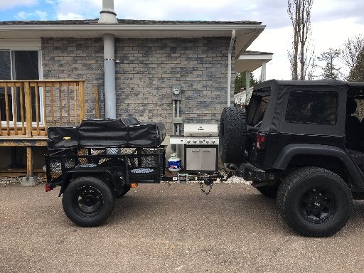

I upgraded the tires to a bigger tire, cant quite remember what size but its the next size up for trailers anys. Only problem with it is that by doing the the clearance between the tire and the trailer its self is kinda close. (Width) so all I did for that was shave some bolts and I just added 4 washers the the lugs behind the tire before putting the tire bolts back on. NOW with saying that do I recommend doing that instead of spacers of offset rims. Not a chance, and ill cross that bridge whenever something happens.
As for the jeep, its a 2013 Rubicon unlimited lemon edition with some 33 KO2s and a Rubicon express 3 inch lift.
