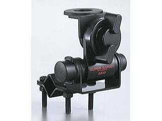

    Someone on my Jeep club site found these. They look like they could be a good mount.

    Diamond also makes a nice roof rack mount.

    Neither of these off a great ground plane since the roof rack bars aren't usually grounded to the body. You'd want to have a good wide ground strap from the mount over to a good ground on your roof to use them effectively. You really have to be weary of that kind of thing, it can make or break your antenna system. Then will work in a pinch, MOST of the time though.
