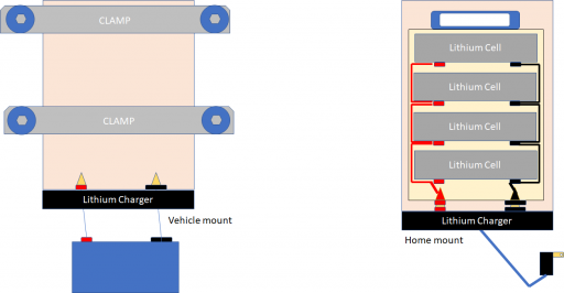

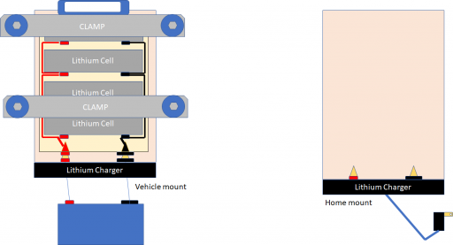

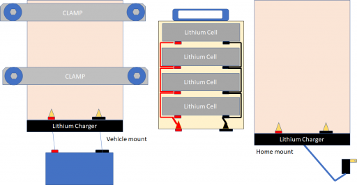

I have a great idea that will make millions or billions.. lol hahahaha
3 images of a mobile lithium battery,
Image 1 - Vehicle and home mounts with mobile battery
Image 2 - Home charging
Image 3 - Car charging and use
So when needed you could take the battery to the vehicle and just slide it in and clam it down. all other times the battery could sat at home warm
On the vehicle mount you could build in a heater sheath to keep it warm when the vehicle is running.
