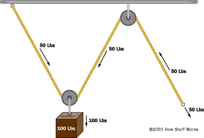

In a double line pull each section of rope carries 1/2 of the load applied to the snatch block. So, if your winch is pulling 10k then the force on each "side" of the rope is 10k and the force on the snatchblock is 20k.
There's a picture on this site.
If you have a 12k winch then in theory the most force it could exert on a snatchblock (and shackle and tree saver) would be 2x12k = 24k. You could use this as your WLL (working load limit) for the hardware, and if you then apply a 3:1 safety factor you would want hardware with a 3x24k = 72k MBS (minimum breaking strength). You'll notice that the MBS for most common snatch blocks is nowhere near this high.

The following is a good example of basic loads. Each pulley you put in the system will increas your pulling power without putting more load on the winch.

The material itself does not "suddenly" become twice as strong. The pulling power becomes twice as strong because you are doubling the line with a pulley or snatch block. The load is spread across two lines, not one. The breaking point is still the same at any point in the line, but because you are doubling the line, the total pull weight is half on each part of the line.
If you set up two pulleys with the same load you decrease the load on each run of line further.
