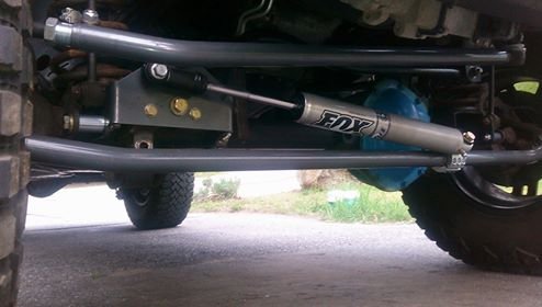

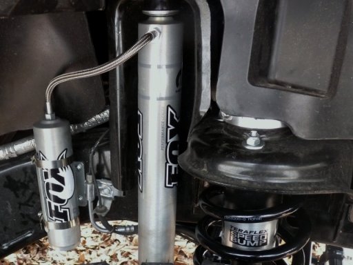

For example...My Rubicon got all squirrely in the front end with my Teraflex lift ($3k) but no worries, spend another $700 in Synergy parts to get it back to sane...lol
