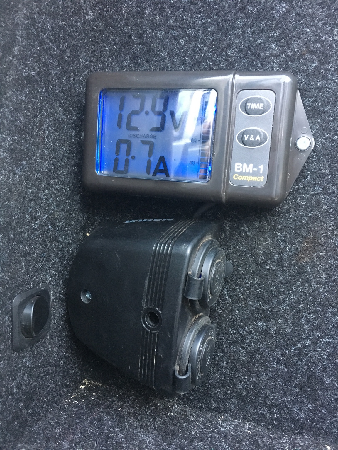

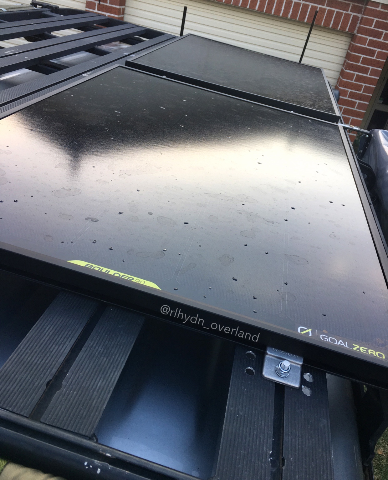

2x wired 90w Goal Zero panels fixed to the roof rack
1x 80w Projecta folding panel using Anderson plugs in front and rear bullbars
Managed by Projecta BCDC
Monitored by a BM-1 monitor
Running 50L National Luna weekender, Handpresso expresso machine, GoPro etc charging, 1000w pure sine inverter for MacBook charging

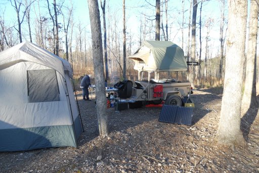

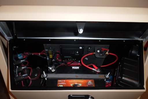

I've owned Zamp solar system on my 5th wheel & found that Zamp produces served me well for years & gave me true clean power deep in bear hunting country or off grid dispersed camping.
My M416 type trailer build, I've looked into every possible solar system available for 6months. Price isn't a problem or issue for me, I wanted reliability & clean power for the build I was doing which 100% offgrid camping only. Having gear that is marked "Overland" doesn't make it any better. I ended up with Renogy. Their customer service is a great experience & their recommendations for what equipment I was going to need. Basically I have a fail safe system that is reliable for "me & the wife" that will fill our needs.
My solar system consist of Renogy 30 amp charge controller is in the nose box (tongue box) of my trailer, 2 100 watt portable suit case Renogy panels with branch connectors & 5ft. pigtail cable, 15ft. of 10awg cable for the solar panel. I can run both 100 watt panels together or just one 100 watt panel shown in my picture which supplies my VMax Tank 125 amp hour AGM battery. The gear I run is Engel 40qt Eclipse 12v fridg\freez, Propex H2000 Heat Source tent heater, Zodi Hot Shower System I converted to 12v., my tent rack LED filtered lights which draws barely anything, & the RTT light strip. 037.JPG 003.JPG 006.JPG

Here's my own solar setup for camping:
Four @gofsr solar-powered Ready Lights with USB ports. Each unit has a large main light on the back and four removable pods that have super strong magnets and hooks and can act as task lighting, flashlight, or emergency flasher. This gives me 16 movable solar-powered pods that charge back up each day when on the mother light. These pods are all I use now in place of stationary LED lights in camp, whether in my van, working around the trailer, or in the tent. The folding panel is 120w Sunpower Maxeon sold by Overland Solar. I have it on a 45' cord, all of 10ga wire, most of which I made myself, with Andersen plugs on each end. 45' lets me move the panel around considerably, and even when under a canopy of trees, I can most always find spots open enough to charge my system.
Here's the power center, from left to right: big hole at lower left is for cords to inverter, etc (has a cover on the outside), solar input (black wire leading to the outside wall), 110 in and out (gray box), protected switches for lights and pump etc, dual Odyssey batteries stacked on brackets one over the other, Blue Sea fuse box. Backed up to the wall at the bottom of the photo is the Noco Gen 2 Battery Charger (for controlling shore power input if hooked up to 110, which I've never had to do yet!). Out of view on the lid is a Zamp Charge Controller for solar input that provides a lot more info than the controller on the folding set, which we bypassed upon purchase.
I've also added a Zamp 1000w Pure Sine Inverter on the left angled wall, and an ARB CKMA 12 air compressor down inside this same compartment.
More about my setup and how it works at https://www.overlandbound.com/forums/threads/on-trail-camp-solar-power.10845/#post-186118

KI7RAM
We move campsites every day so it was important to have a small footprint and the ability to store the solar panel in the RTT. Really only use it if we find a site to stop for a couple days. Otherwise the battery powers the fridge and other items just fine.
I ended up with a Mohoo panel with a Victron Energy SmartSolar charge controller.
