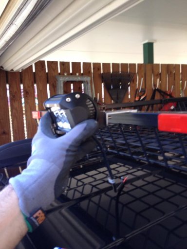

I want side illumination off the rig for camping etc with these 4 18W slim LED’s
ok my desire is to add 4 LED's to the factory roof rack channels
this works for my 2004 gmc yukon, not sure if all years are the same
I discovered through online research that Fastenal Part No. (SKU): 48590 seemed to be the part I needed ~ https://www.fastenal.com/web/products/details/48590?searchMode=productSearch&filterByVendingMachine=
so I got 8 of these 4 as spares, bag of 1" fender washers & 3/4" 1/4X20 bolts
these channel nuts are tapped for 1/4X20 thread, which easily handles the weight & load of any small light like this
Parts all gathered:
I decided to have the channel nut on the bottom of course, then a washer, the mounting bracket & then another washer to finish it all off
this keeps everything very tight
I had to put the channel nut down on the outside lip of the factory channel & give a firm downwards push to get it in & you may too
once its seated it looks like this
& a wider view
