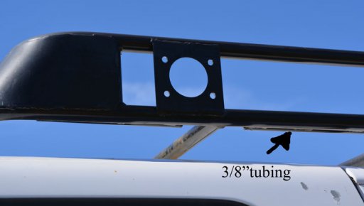

The roof rack got removed and finished when we returned from the Anza trip for more welding and last minute add-ons. So once I was sure I had thought of everything I took it over to be sandblasted and then powder coated.
Note - plug for "R&R sandblasting" If you are near the Corona east Riverside area R&R Powder Coating is a great place to go, great friendly people and I also get a fair price on things and the quality is wonderful. I have had well over 100 things done including a 65 Chevelle chassis and suspension parts for 5 cars or so over the last 8 years or so.
One thing I added to the rack were 3/8" tubing pieces across the front bottom tube, drivers side bottom tube and across the rear bottom tube. Reason is so I can run the wiring for the lighting in them and not have to drill into the main tubing for clamps and such.

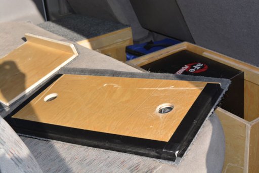

Boxes for the back floor of the cab, needed to be as big as possible while allowing the driver’s seat to go back far enough for my long legs to be comfortable on long drives.
This is another big reason we went with a full size truck, comfort for me and my long legs on long trips. We have done 11 hour days of driving and other then the diesel noise the inside is great.
Both cab boxes are the same design with lids, they do not meet in the center of the truck. I made a fill cover that allows for quick hidden storage in the middle between the two boxes. Now Ernie has a complete flat table top for trips and it is big enough for has glamping bed to fit, so he feels at home while driving and when we get to our spot.
The tops were left the bare finished birch at first, but it was too slippery for Ernie to stand on and he was still falling just not on the floor. So we got some indoor outdoor carpet at Home Depot and 3M 77 spray glue and glued the carpet to the tops of the lids. Now Ernie is stable and good to stand at the window with face out in the wind!
Duct type on the bottom of the lids is to stop the clicking and banging of the lids on the tops of the boxes.

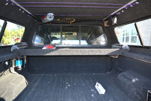

The shell came with an 18" wide shelf at the front for the PO's dog to sit on. We use it for clothes and stuff when we go camping/overlanding as we sleep inside the shell. It works out great as we sleep heads to the tail gate, so when we sit up, we are facing the front of the truck & shelf to grab things easily.

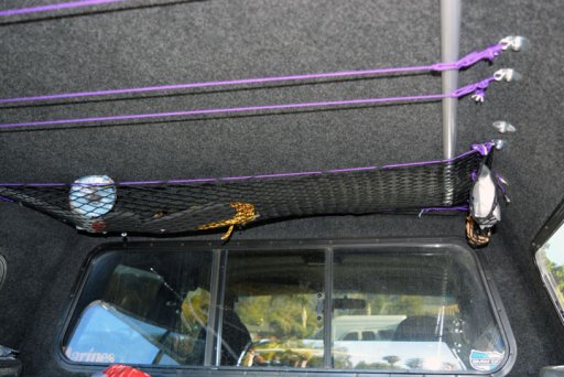

Also you can see purple para cords and a net hanging from the ceiling of the shell. I used the bolts holding the rack to the shell along with some old holes from the PO. I put bolts in them to pug them. I got 1/8" steel "S" hooks, fender washers and some nylock nuts to do this with. All the hardware including the bolts are stainless steel to avoid rusting. All the bolts were packed with wind shield adhesive/sealant to insure they would not leak. We were having issues with leaks before this.
We use the net for flip-flops socks underwear and things we want to get to easily.
We use the para cord lines for hanging wet things such as clothing, towels and dash rags to dry on during the day when not sleeping in bed.

Adding gear to the truck and finding places to put it all is an on going task. As putting things in places or making places to easily access them seems to be an on going revolving saga. Because you try something and then realize that just does not work.
First place I filled was the area behind the rear seat. In the Ford Super Duty Crew cab the rear seat back floods forward to expose a good size area for things. The factory bottle jack is there on the passenger side the rest is empty while some owners choose to fill this area with stereo equipment. I choose to put tools, recovery gear, extra oil and some extra small engine parts for break downs.
The red plastic tub on the far side is a plastic tool box that had a carry handle in the middle with a tub on each side. I cut it in half so one side could fit behind the seat. I originally had both in there but as I bought more tools and tool bags I took one out. Also I had made the boxes in the bed, so I was able to move stuff was back there for easier access and use.

Another piece of gear we saw Overland Expo this time 2016 was the ARB twin 100% duty cycle compressor. It was a hard buy because of the price, but after looking at compressors for a few years this was the one we needed. Because the Super Duty is fitted with E rated tires and run them at 75psi when towing Bob on the highway any other compressor would just take way too long to re-inflate the tires after being aired down. Or if we ever have a plug able flat.
I choose to mount it in the front of the bed out of the way for us to sleep and pack the bed for track days. Which by the way it works great for airing up the track car and trailer tires also! There is no extra room at all in the engine bay with the 7.3's dual batteries, air, countless coolers, piping and engine, so the bed or under the truck was my only option.
the temporary air plumbing and bed electrical, I plan to move the air fittings to the bumpers once I make them as well as add more charging capabilities down the road. For now this works well and we can plug the Solar into the truck and top off the trucks batteries. I also have room to add in lighting and maybe a radio in the back.
