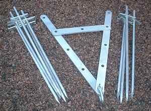

I know of at least 7 different ways to do expedient anchoring. Im just wondering what others are using since everyone is in different local terrain. The one i was hoping would be mentioned is the stake type anchors that they use in the uk, most of their stuff is that soggy peat bog. Why do we not use them in america? If they work for landrovers in soggy stuff why woildnt they work here? I know using them in sand is out of the question but in mud and rocky terrain on paper they seem like they would work pretty good. They are just a fancy version of a chain and some rebardownloadfile-21.jpg

I know of at least 7 different ways to do expedient anchoring. Im just wondering what others are using since everyone is in different local terrain. The one i was hoping would be mentioned is the stake type anchors that they use in the uk, most of their stuff is that soggy peat bog. Why do we not use them in america? If they work for landrovers in soggy stuff why woildnt they work here? I know using them in sand is out of the question but in mud and rocky terrain on paper they seem like they would work pretty good. They are just a fancy version of a chain and some rebarView attachment 101651
I've never even heard of this style. DO you have any more info on them?

Have an idea to do something similar using the hilift main shaft and pound 30 inch 1/2" rebar through the holes in opposing directions and attach the winch to the end of the hilift shaft.
