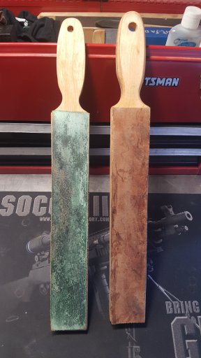

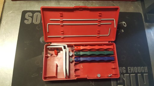

I use a Lansky system and leather strops at home. Getting and maintaining a edge is essential before taking with me.

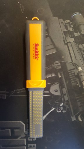

I really like this smith 2 sided sharpener for the field. Also use this on my axes and hatchets.
